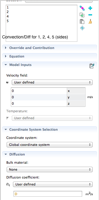

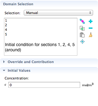

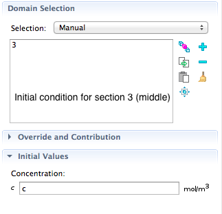

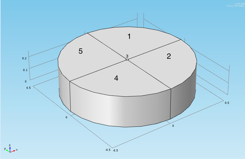

Posted:
10 years ago
04.08.2014, 05:32 GMT-4
Here are some screenshots of my model -- maybe it'll be easier to see my error if you look at them? I have labeled what each screenshot is as text on the picture itself.
After running this model with a normal mesh, I still get the following error:
Failed to evaluate variable Jacobian.
- Variable: D
- Geometry: 1
- Domain: 1 2 4 5
- Variable: D
- Geometry: 1
- Domain: 1 2 4 5

Posted:
10 years ago
12.08.2014, 03:46 GMT-4
I think you need to extend the bigger cylinder in the positive and negative z-direction because the nonanal can also diffuse in that direction.
Also, there will be no diffusion inside the arm itself right?
You have not defined D and c. You can define them by adding a 'parameters' node to 'global definitions', and putting them their with the number that belongs to them.
