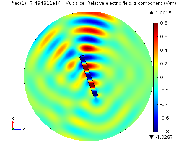

I'm trying to model the scattering effects of light off of a thin box. I used the model example "Optical Scattering Off a Gold Nanosphere" as a reference model. " I've tried a few approaches when modeling the system, and I keep getting the error "Undefined value found - Detail: NaN or Inf found when solving linear system using SOR. - Feature: Stationary Solver 1 (sol3/s1)". I don't know where exactly the undefined value is coming from. How can I avoid/fix this error?

You are getting this error message because mesh element size is larger than wavelength. You defined appropriate parameter for mesh size (h_max) but didn't use it for mesh generation.
Attached is your modified model which solves the problem without getting error. Note that at the frequency you specified computation requires ~40G of RAM.
Sergei

Thank you! I've got the model running as intended. You have been very helpful.
