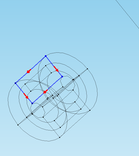

i have created a model with a Multi-Turn Coil (rotating body).
Now i try to exchange the rotating body with a CAD Model (looks like a
4 rectangular tube), but i can't define a Input Boundary for a Current.
It would be great if someone can give me a advice.
A second issue arise when i try to create a mesh. I cant use a size bigger then "Finer".
is ther a possibility to create a normal size mesh?
Thanks for your help,
cya Thommy

Good morning,
does nobody knows a way to use the square tube as a coil?
I can't define a (correct) Boundary as an input Boundary.
cya Thommy

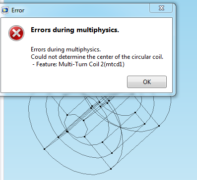

I'm facing the same problem, did you find a solution? I built the geometry that needed multi turn coil input but it is a square and I get an error that it could not determine the center of the circular coil. And the direction of the input current doesn't not follow a unidirectional course. Please let me know if you could solve this.
Thank you.
