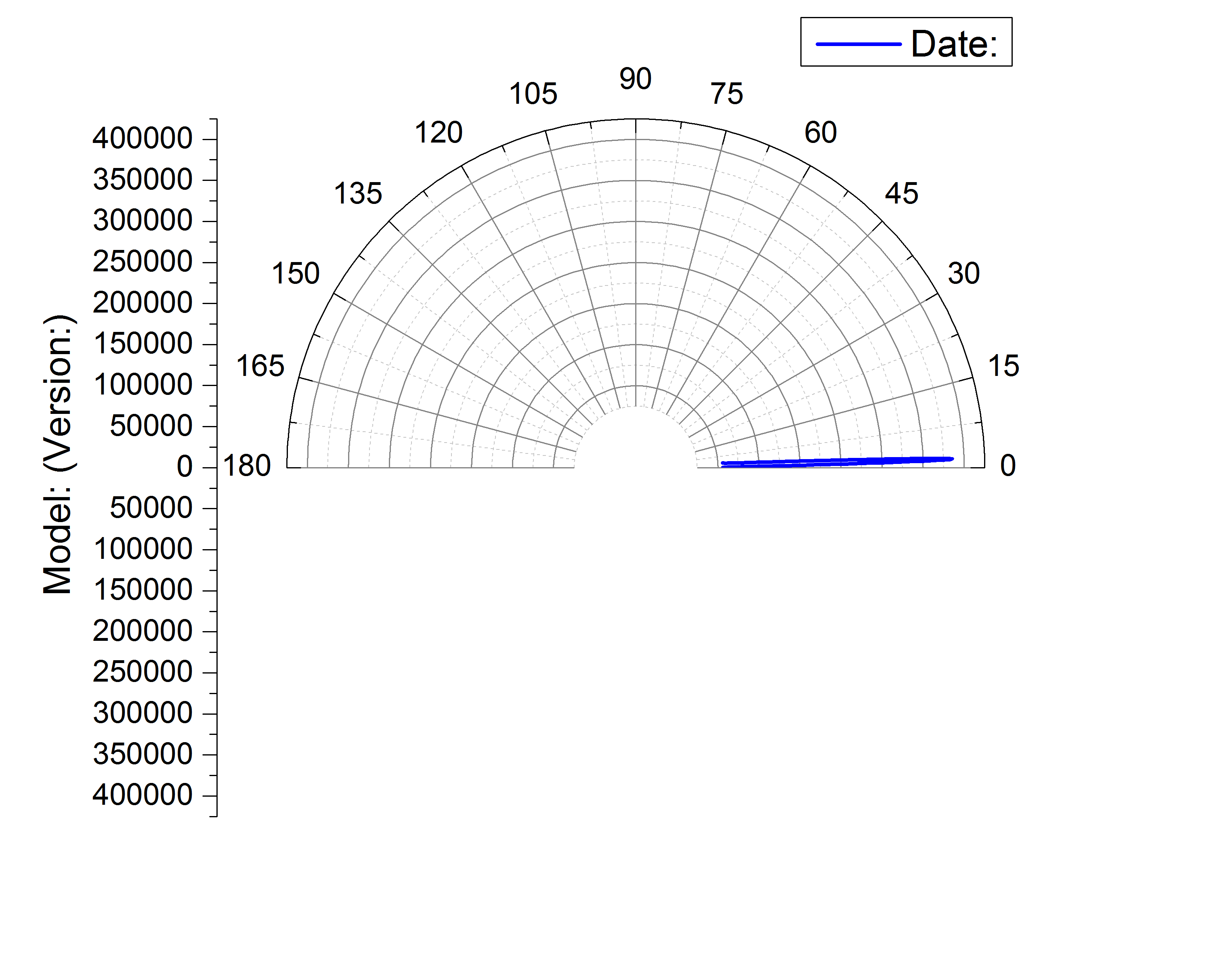

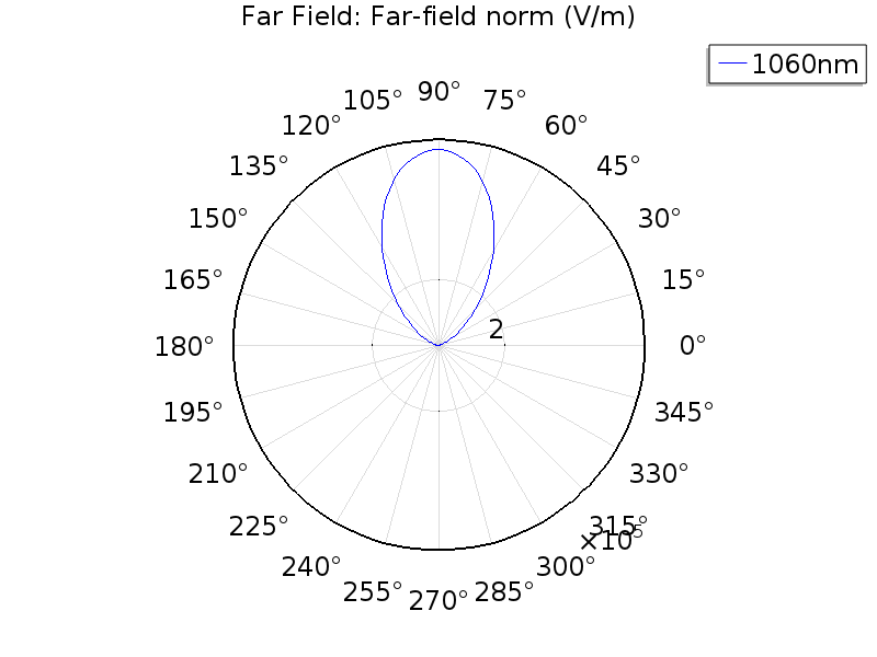

Herewith I had attached the model. You can see the Polar-plot in COSMOL. When i tried to export and plot in origin, I cant obtain the same plot when I tried to Polar plot in Origin program.
I would like to know how we can plot like the same in COMSOL graphics.
Thank you.

The angles in the exported plot data are in radians, not degrees. If you adjust for this in the external program where you create the plot, then you should be able to get the plot that you want.

Thank you. I got it now. Successfully plotted in origin program after converting radians to degrees.
