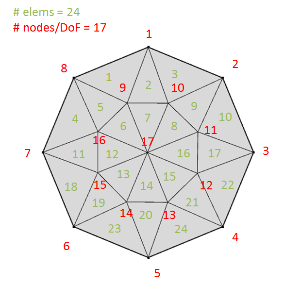

Why can't you have more elements than nodes? You definitely can. See attached mesh with 24 elements and 17 nodes.
Also, I created a simple cube and meshed with an extra fine mesh resolution with the free tetrahedral mesher.
Results:
~400k linear elems
~69k DoF (nodes)
That is a ratio of 0.175 -- very close to the value given by the Knowledge Base post you referenced:
(#of DoF) = 0.2 * (#of Elems)
Josh Thomas
AltaSim Technologies
Joerg- Why can't you have more elements than nodes? You definitely can. See attached mesh with 24 elements and 17 nodes. Also, I created a simple cube and meshed with an extra fine mesh resolution with the free tetrahedral mesher. Results: ~400k linear elems ~69k DoF (nodes) That is a ratio of 0.175 -- very close to the value given by the Knowledge Base post you referenced: (#of DoF) = 0.2 * (#of Elems) Best regards, Josh Thomas AltaSim Technologies

Hey Josh,
thank you so much for this picture. That was a real eye opener. I always assumed that there must be more vertices/nodes than tetrahedra. That is why outputs like
Results:
~400k linear elems
~69k DoF (nodes)
confused me in the first place. I just didn't have a proper counter example. Thank you so much. Now my FEM world view is back to normal again. :)
Btw, do you have any idea where the ratio 0.2 is coming from?
Greetings Joerg
Hey Josh, thank you so much for this picture. That was a real eye opener. I always assumed that there must be more vertices/nodes than tetrahedra. That is why outputs like ========== Results: ~400k linear elems ~69k DoF (nodes) ========== confused me in the first place. I just didn't have a proper counter example. Thank you so much. Now my FEM world view is back to normal again. :) Btw, do you have any idea where the ratio 0.2 is coming from? Greetings Joerg

You're welcome, Joerg. A picture is worth a thousand words!
Where exactly does the 0.2 ratio come from? I'm not sure. A round-off of 0.175 maybe? I tried a cube and a sphere and got the same ratio of 0.175 for Extra fine free tet mesher.
As is pointed out in the Knowledge Base article, the real ratio is going to depend on how much surface area per volume your geometry has. My intuition tells me that a sphere (lowest surface area to volume ratio of any object) is going to have the smallest node to element ratio possible.
Josh Thomas
You're welcome, Joerg. A picture is worth a thousand words! Where exactly does the 0.2 ratio come from? I'm not sure. A round-off of 0.175 maybe? I tried a cube and a sphere and got the same ratio of 0.175 for Extra fine free tet mesher. As is pointed out in the Knowledge Base article, the real ratio is going to depend on how much surface area per volume your geometry has. My intuition tells me that a sphere (lowest surface area to volume ratio of any object) is going to have the smallest node to element ratio possible. Best regards, Josh Thomas AltaSim Technologies
