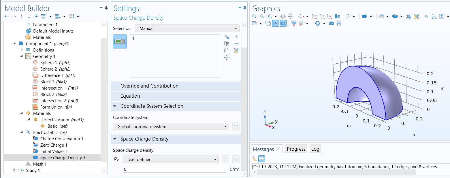

Hello everyone, I need to add this formula for the space charge density:
where and with
Could you tell me how to do it please? In the figure I found where to write the formula of the space charge density, but I need to know how to write the spherical coordinate r.

Simply express r in Cartesian coordinates. E.g., see https://en.wikipedia.org/wiki/Spherical_coordinate_system

Thank you for your useful suggestion @RobertKoslover.
