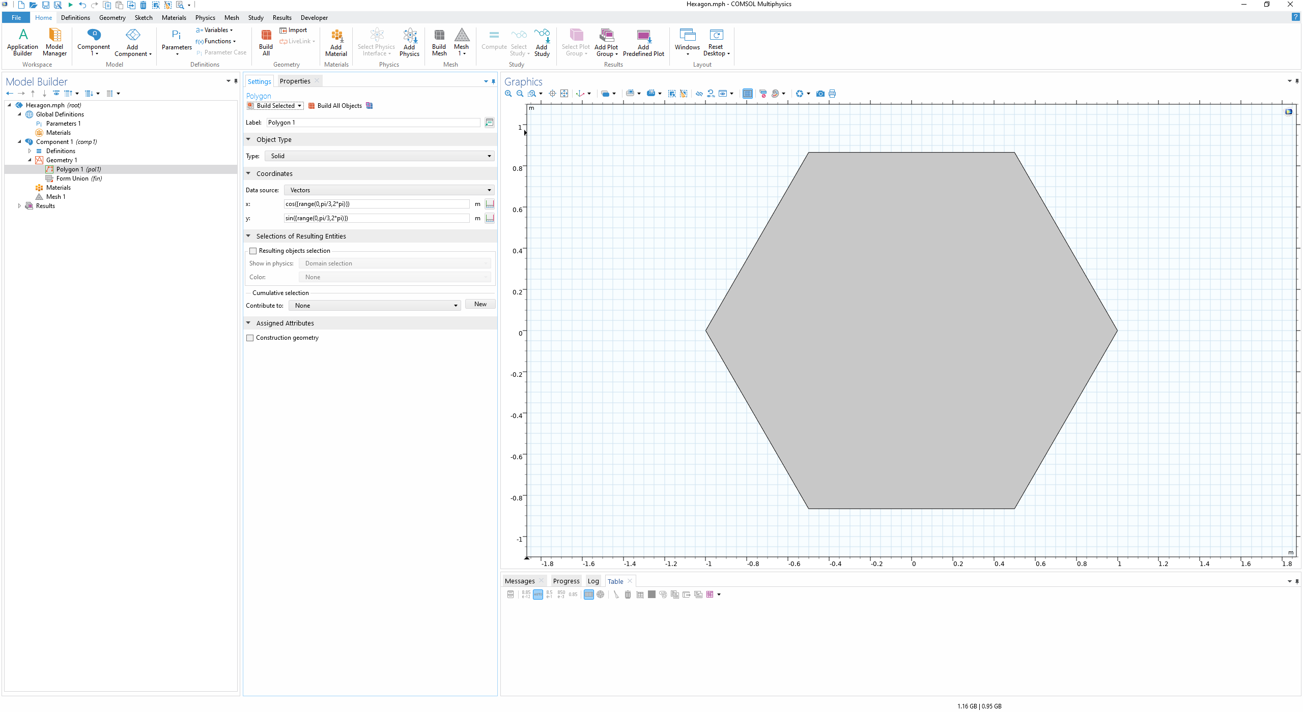

Hi again,
You will find the formulae in the file Hexagon.mph attached to my post in the thread I mentioned. In case you are unable to open that file, you can see them in the attached screenshot.
Jeff Hiller
Hi again,
