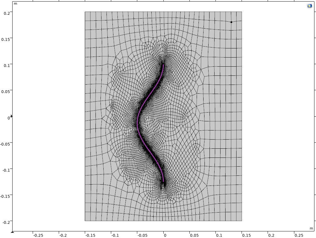

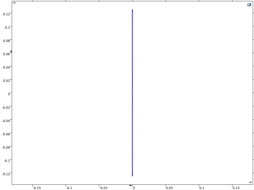

I have a linear elastic thin beam (2D), which I am buckling (first mode) to a desired clamp-to-clamp distance in a stationary study. I now want to take this buckled beam into a fluid filled tank (also 2D) and perform further structural analysis in the fluid medium (FSI). (The situation is like, I am buckling a beam in air, then taking it underwater for further analysis.)
I have remeshed the deformed shape of the beam and used it as geometry input for the solid part of the FSI (as explained here: https://www.comsol.com/blogs/how-to-reuse-a-deformed-shape-as-a-geometry-input/ ... (1)), and I have a rectangular fluid tank around this geometry.
The issue is, this incorporates the shape of the beam, but not the stresses generated in the first study. I want to include the stresses also. I see a lot of comments on this issue in the link(1) above as well.
I have tried saving the stress values(solid.sx, solid.sxy, ...) from the stationary study in a file, then creating an interpolating function using that file, and entering that function in the 'Initial Stress and Strain' node and 'External Stress' node, but the error "Failed to find consistent initial values" shows up. Is there a standard way of including the stresses also along with the geometry from a previous study? Is there a blog written about this topic as was suggested in the link(1)?
