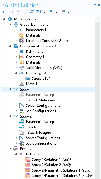

Thank you Mats. I was able to get number of cycles for a range of load (using parametric sweep), but to plot them in an S-N curve I need stress data from the result of Study 1 (Stationary analysis) and number of cycle data from Study 2 (Fatigue analysis). Is it possible to plot this graph in Comsol or the only way to do it is to export data and use other plotting software to do that. I have attached my model builder sceenshot for reference ?
