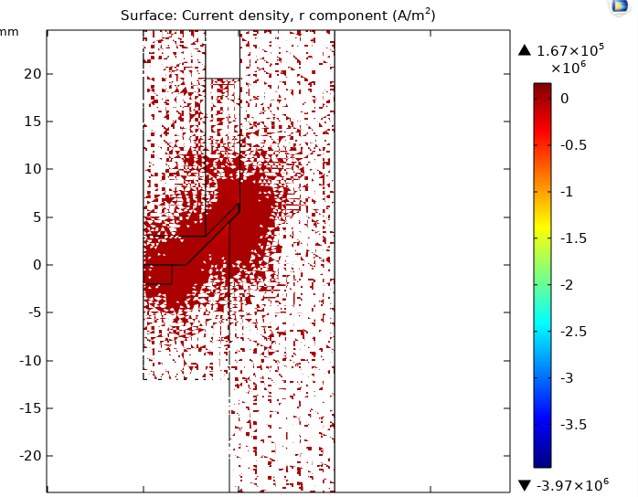

please check the data range section in the plot settings.
if you have set the data range to manual, then only a part of the data will be plotted and rest will be blank.
not sure of any other solution to this problem.

What graphics card and driver do you use? I think that I remember seeing what you see in problem.png for a buggy graphics driver. I recommend you to update the graphics driver to the latest version.
