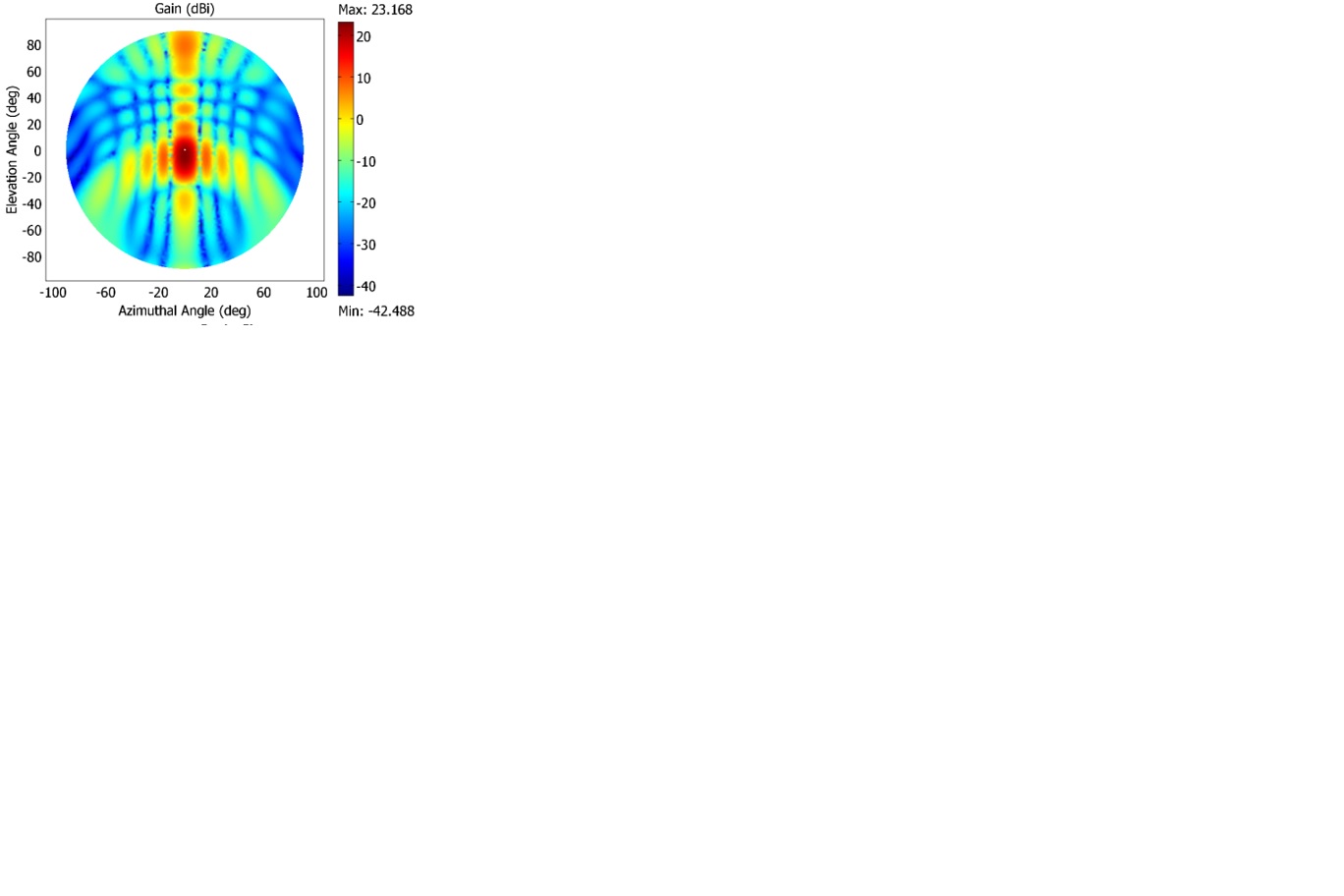

Ah. In the years prior to Comsol providing far-field pattern plots in post-processing (and before that, computing any far-field quantities at all), if you wanted to compute and plot something like that, you could place a sphere around the origin and create/write a set of your own equations, to compute and plot the quanties of interest on the surface of that sphere. I used to do that, long ago. I also remember looking at spheres along the axis, and making plots (on the screen) just like the projection you mentioned. I presume that same technique still works. I've attached an example image. Alternatively, if you want to actually make such plots on a disk (instead of looking at a sphere from a particular perspective) you ought to be able to do that via judicous use of coupling variables. I suggest you investigate along that path.
Ah. In the years prior to Comsol providing far-field pattern plots in post-processing (and before that, computing any far-field quantities at all), if you wanted to compute and plot something like that, you could place a sphere around the origin and create/write a set of your own equations, to compute and plot the quanties of interest on the surface of that sphere. I used to do that, long ago. I also remember looking at spheres along the axis, and making plots (on the screen) just like the projection you mentioned. I presume that same technique still works. I've attached an example image. Alternatively, if you want to actually make such plots on a disk (instead of looking at a sphere from a particular perspective) you ought to be able to do that via judicous use of *coupling variables*. I suggest you investigate along that path.
