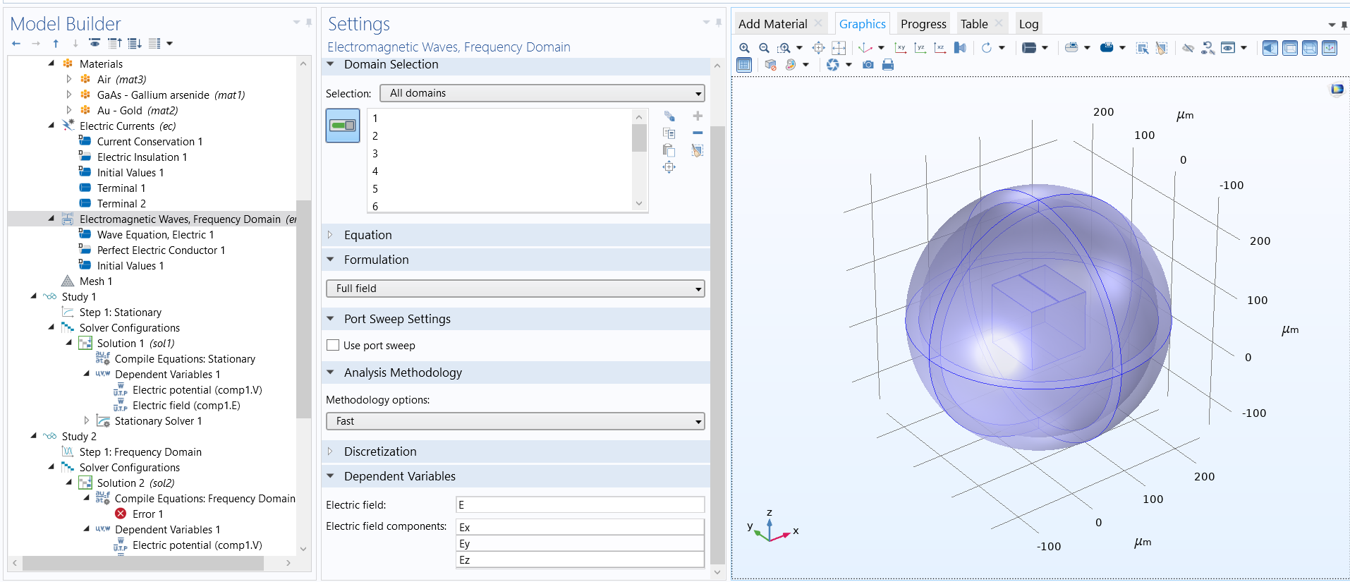

I'm a beginner in COMSOL. I applied a DC voltage difference in Electric Currents physics and I got an electric field. I want to use that electric field in Electromegnatic Waves physics.
Someone advised me to use dependent variables to read the value of electric field from a different physics.
I need to know how to do that in details, please
Thank you

How can I compute the ac dc module and submit the dependent variable values to the second study which is the electromagnetic wave study?
