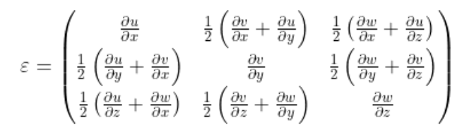

2) In one of the equations, I have to consider the time derivative of the strain tensor, that has the formula shown in "IMAGE_1" attached.Again, since I only have x- and y-directions, when I have to consider the time derivative of this matrix in comsol I type "uxt" for the first component, "0.5*(uyt+vxt) for the second component and so on.

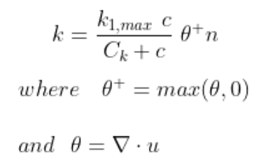

3) In one of the equations, I have the term indicated in "IMAGE_2", so when I have to write this in COMSOL I type "(k1max/Ck+c)* (n) * (max(ux+vy),0).
4) Finally, I have to model a piecewise term and by reading some other threads I thought to write: (ab) * (x<d) * (x>c) where a,b,c,d are numbers and x is the variable theta indicated above. In this way I hope to model del condition: if c<x < d then (ab) is different from 0.
