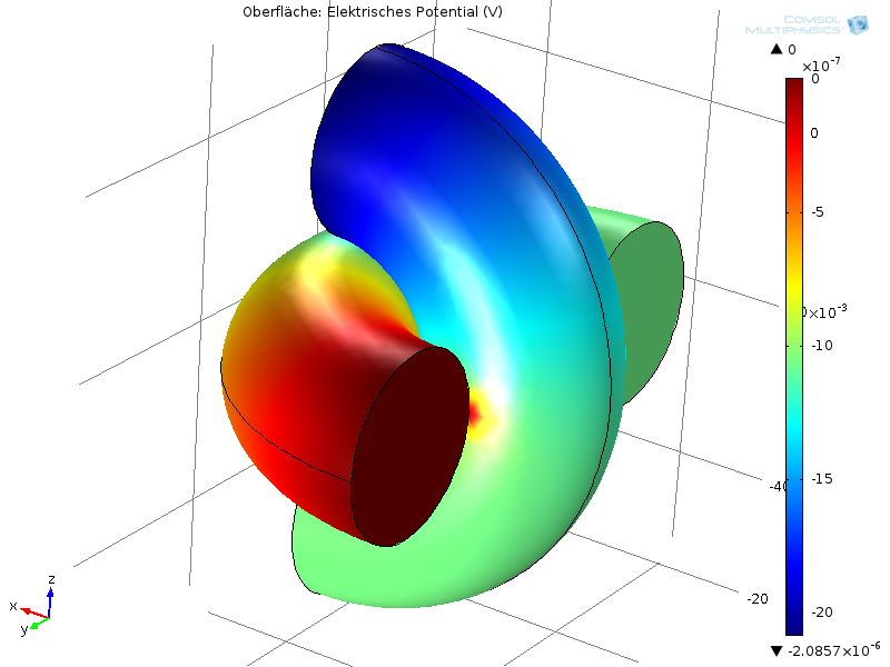

Hi!
For 1) you can change the relative repair tolerance for "Form Union" to 1e-2; this will solve the first problem...
For 2) I can define a contact pair, if I set repair tolerace to 1 and select assembly; see attached file (for 4.2a).
Ralf
Hi! For 1) you can change the relative repair tolerance for "Form Union" to 1e-2; this will solve the first problem... For 2) I can define a contact pair, if I set repair tolerace to 1 and select assembly; see attached file (for 4.2a). Ralf
Posted: 1 decade ago 13.03.2012, 04:33 GMT-4
Thank you!! I appreciate your help. For (1) I tried as you suggested, making repair tolerance as 1e-2 and it worked. Although I still don't understand the significance of repair tolerance in the context of this geometry (i.e. why it worked for 1e-2 and not for 1e-3)
for (2) I tried defining contact pairs in assembly but I still don't get the answer. Unfortunately the file you've attached is in 4.2a, which does not open in 4.2. Did you get a different solution than case (1)? By defining a contact pair does comsol automatically assume a value for contact resistance?
-Vaibhav
