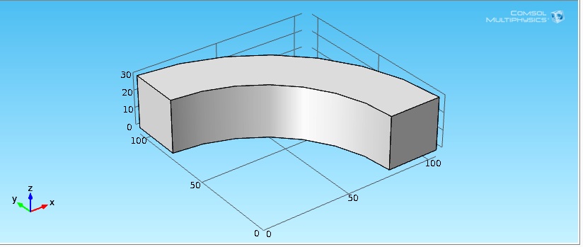

Posted: 1 decade ago 02.02.2012, 10:17 GMT-5
For your referenc,e I am attaching the image of the geometry file herewith.
Thanks again,
Akshay
