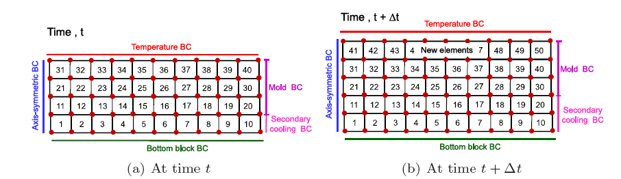

For my problem...The geometry grows in each time step...
If i want to remesh the geometry at each time step ..how i can proceed...

for me, i want to create a mesh in such a way that the MATERIAL node & MESH node always COINCIDE. but i want new layer of MATERIAL & MESH nodes...that means domain growth in specified direction...i have tried all possibilities upto my knowledge..i couldnt succeed in comsol...
kindly give your suggestions....
