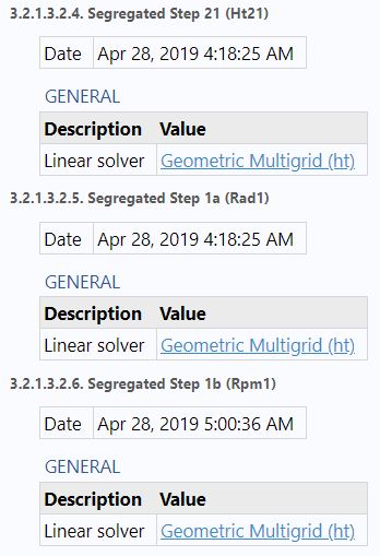

In COMSOL Multiphysics 5.4, I had run two simulations using the Time-dependent Study. In them, the Iterative solver was used. According to the Complete Reports that were written from these simulations, there were three additional Segregated Study steps done in Simulation #2 that were not done in Simulation #1. These additional steps, as they are described in the Complete Report that was written from Simulation #2, is attached to this post as a JPG image ("AdditionalSegregatedStudySteps.JPG").
May you explain how the execution of these three additional Segregated Study steps in the Time-dependent Study affects the results in terms of their accuracy?

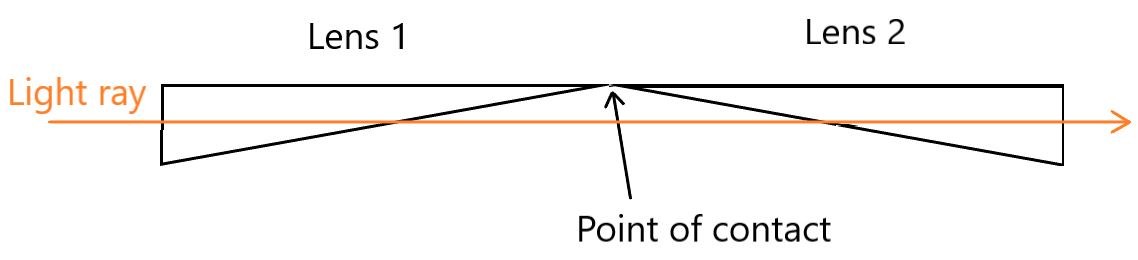

To give you an idea of what the physical contact between the lenses looks like, please see the JPG image attached to this post named "TrianglesInContact.JPG". Then extrude these triangles into the screen/page such that there are now two triangular prisms in contact with each other at one of their edges. Along the direction of the extrusion, there are 13 linearly-spaced rays that travel into the prisms in the direction shown in that JPG image.
In the Geometry of the two lenses, there are 114 such edges of physical contact.
