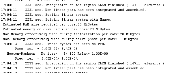

I'm interested in the intermediate steps too, to decide whether to kill the simulation or nor.
How can I save the log in an external accessible file?
Something like the attached image.
It would be great!
thanks
[QUOTE] By the way by default the logfile is deleted upon closing COMSOL, except if you say otherwise in the (Options Preferences) [...] you could also suggest to add the execution time to the log file, where it really belongs [/QUOTE] I'm interested in the intermediate steps too, to decide whether to kill the simulation or nor. How can I save the log in an external accessible file? Something like the attached image. It would be great! thanks

The model builder tree is not accessible during the solution.
Is there any file with this info stored?
Or is it possible to force Comsol to write something somewhere at each solution step?
thank you!
The model builder tree is not accessible during the solution. Is there any file with this info stored? Or is it possible to force Comsol to write something somewhere at each solution step? thank you!
