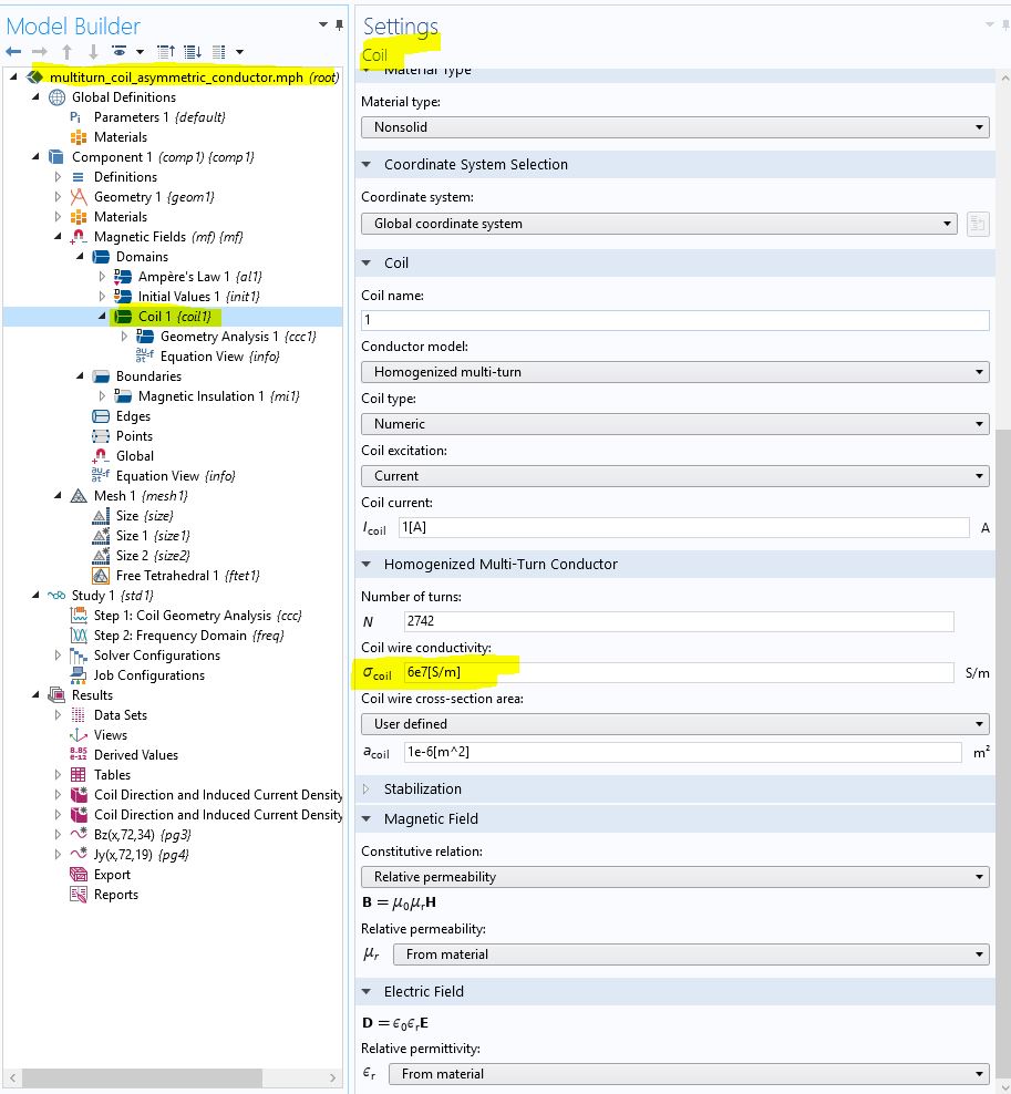

I'm trying to simulate a multiturn coil with an iron core, with a certain BH curve. Simulations run well, but for the same applied voltage, but different coil resistances, it always gives me the same current.
I've tried to use the electrical circuit physics as in the E-Core Transformer example, but the results are the same.
Can anyone help? How is the coil current calculated?

It is most likely you did change the electrical conductivity in the coil domain, but you would need to change the "Coil Wire Conductivity" to change the materials of the wire in the coil. See the attached image. The "Coil Wire Conductivity" is the value that is use in the software to compute the resistance and hence different current when this parameter is changed.

But the way I change the resistivity is by changing the Coil Wire Cross Section Area. Nothing else.
