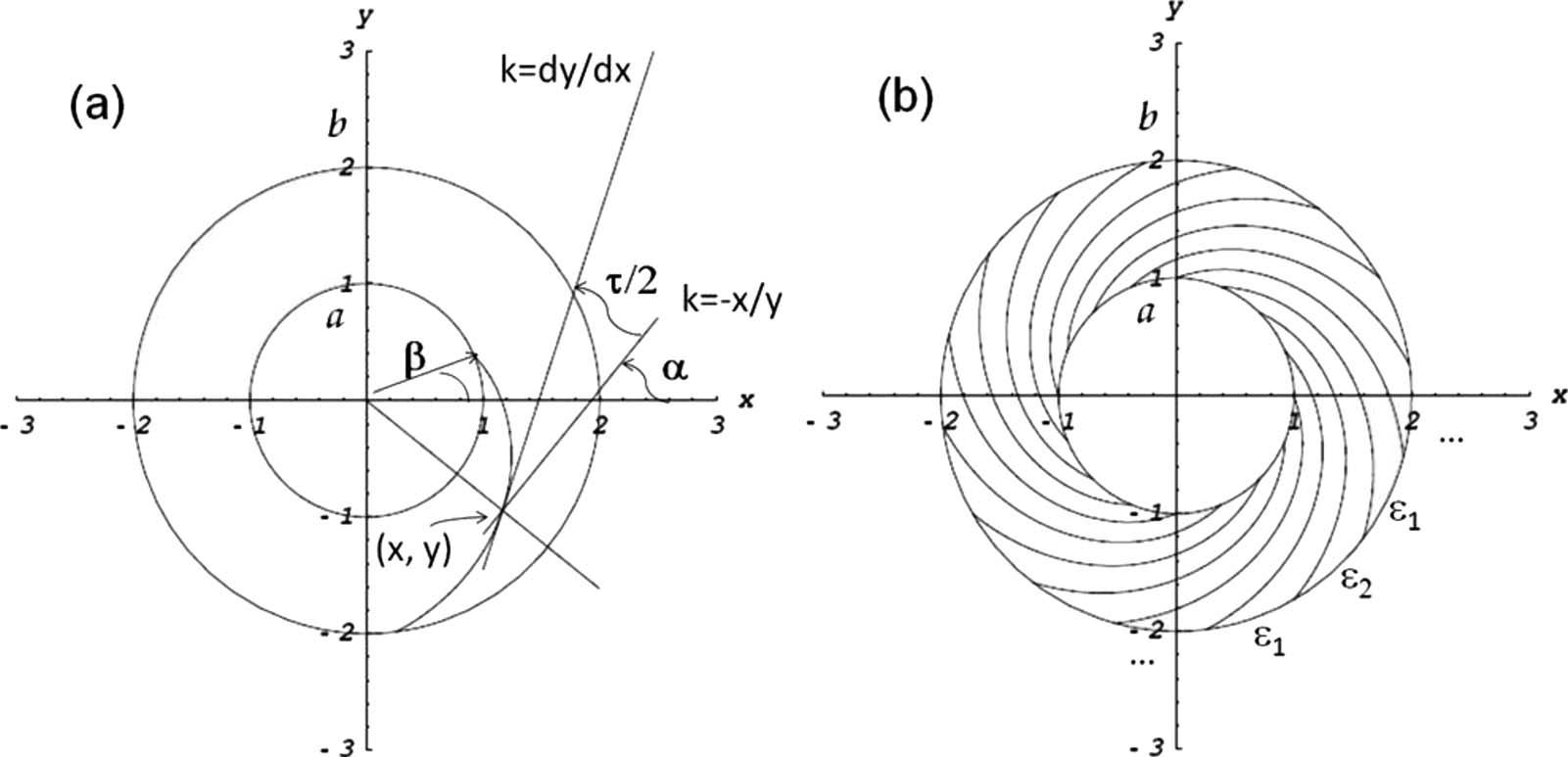

I am looking to draw the concentric shells as shown in the uploaded figure, it is a rotator design. I am having difficulty drawing the layers with parametric curves. In polar coordinates , the equation is
r = a * exp( theta/cot(tau/2)) ; where tau = 0.5* (sqrt(t^2+4) -t); and t = rotation angle / log(r2/r1)
where r1 and r2 are inner and outer radii.
with parametric curves I just get straight lines.
Advice and help in drawing the curves ( to construct the layered material is appreciated).
Ref : H Chen and CT Chan,Electromagnetic wave manipulator by layered systems using transformation media concept, PRB 78,054204(2008)
thanks in advance.

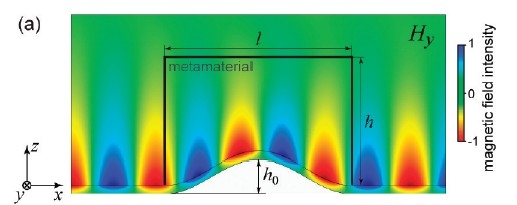

Hello, I have the similar problems. I want to draw a function curve y=a*cos^2(pi*x/b) to get a bump region, but in the parametric curve, I only get some lines.
Details of my setting:
Parametric Curve
Parameter: s
min: 0
max: 1
Expression:
x: s
y=a*cos^2(pi*s/b)
thanks for your time and consideration
Rugang Geng
