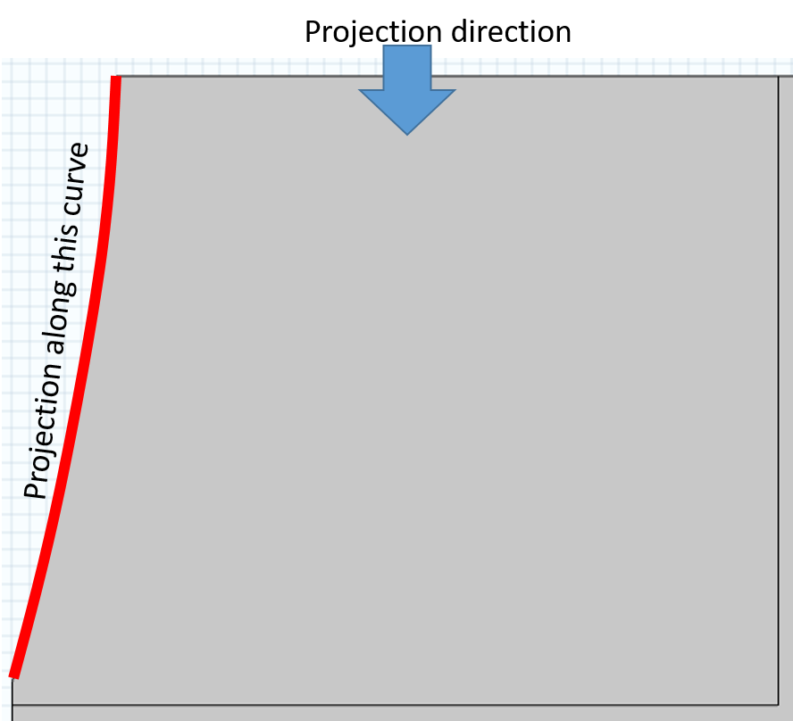

Hi all,
I am trying to do something like the projection but not along the straight lines. As shown in the attached figure, I want to calculate data long the solid red curve. As far as I know, the general prejection should work for integrating along a curve, but I did not find the way to enter the function for this curve.
Does anayone have idea how to do this? Or, is there a different way can achieve my popurse?
Thanks!!

Hi Zhidong, you could use particle tracing to do that. A particle can integrate everything along its path. Sven

Hi Sven,
Thanks for your suggestion. Particle tracing is a module. Do I need to add it as a physics and simulate particle transport? If you have time, could you please provide a bit more information? Thanks in advance. Best, Zhidong

Hi Sven,
I could not figure out how to use particle tracing to solve my problem. Now, I can use Matlab to do the averaging calculation after exporting data from Comsol.
I have one more question about how to export data for a specific region. I tried to use Grid 2D, but it only works for 'Globally defined expressions'. When I choose the dependent variable (concentration), it gives an error message 'Undefined variable'. Are there other ways I can do this?
Thansk!!
Hi Sven, I could not figure out how to use particle tracing to solve my problem. Now, I can use Matlab to do the averaging calculation after exporting data from Comsol. I have one more question about how to export data for a specific region. I tried to use Grid 2D, but it only works for 'Globally defined expressions'. When I choose the dependent variable (concentration), it gives an error message 'Undefined variable'. Are there other ways I can do this? Thansk!!
