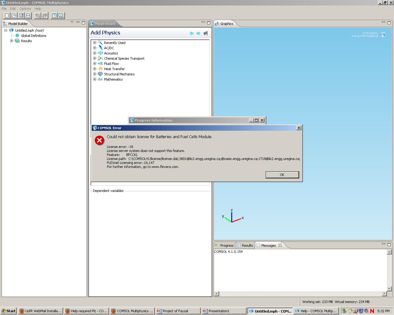

I am very sorry to let you know that i can not open your file cause i do not have the license for Batteries and Fuel cell mode ........

Dear Mayur,
Thanks again for your reply. Really grateful.
Please check the JPEG picture. This is what i am having trouble opening your model in my PC.
Regards
Faysal
I don't know whats the problem is, I have used the physics under chemical engineering, fluid flow and heat transfer...so there must be something else! may be you should contact the support related to this.
