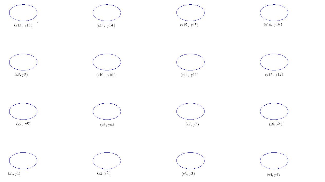

I made a MATLAB program which is plotting circles of same radius at different centre points. The centre points are placed to circles using for loops. (The schematic of pattern is attached in the file)
