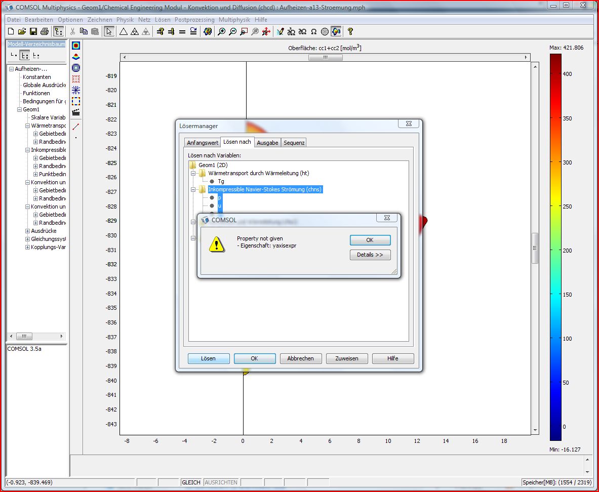

Is there anybody who knows this error:
"Property not given: yaxisexpr"
My model gets a stationary solution. After restarting the simulation to get a transient solution I get this error.
** Now I get the error by using the parametric solver AND restart, too!
Exception:
com.femlab.jni.FlNativeException: Property not given
Messages:
Property not given
- Property: yaxisexpr
