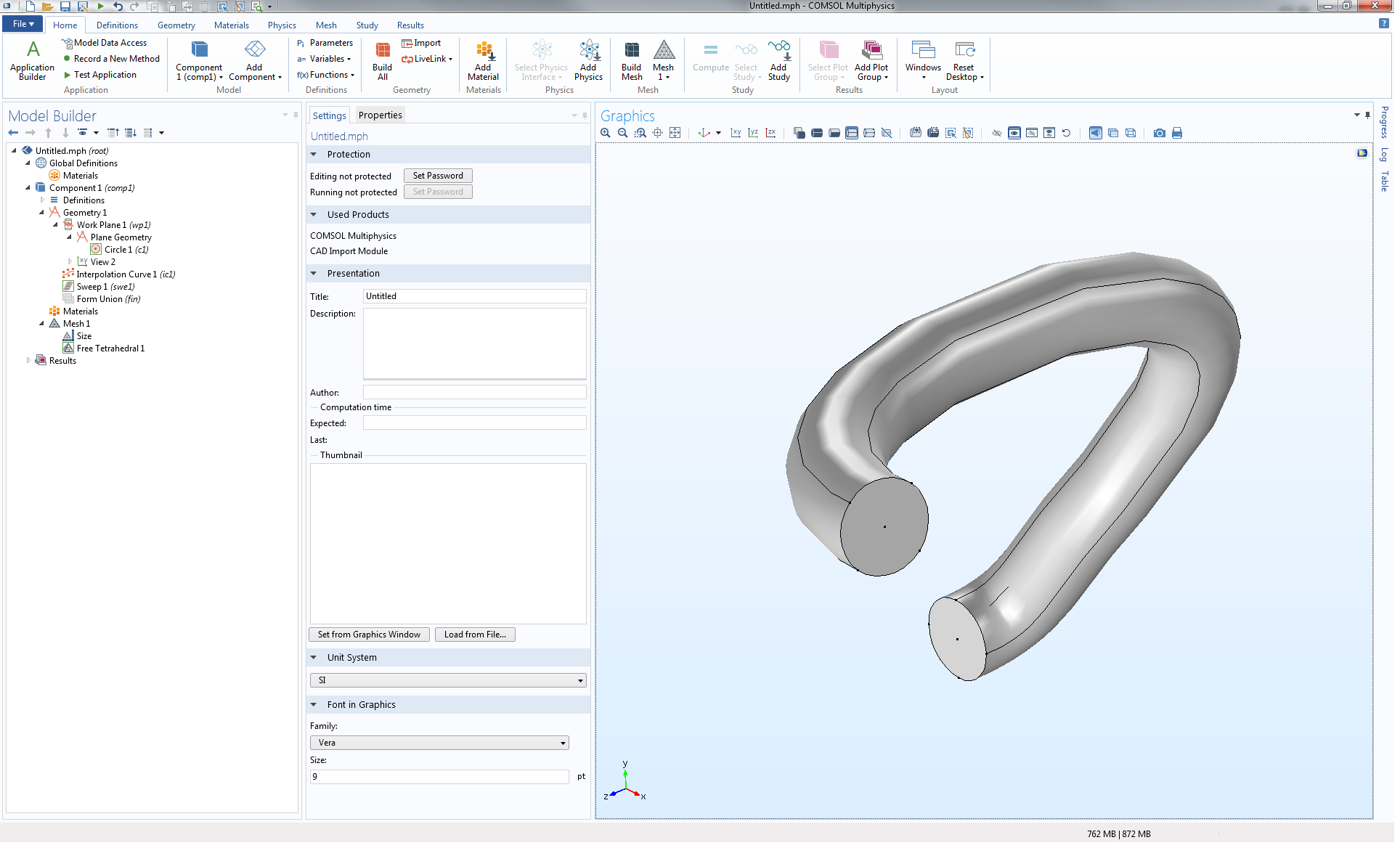

Hello Chachin,
As Lasse suggested, a fraction of a torus could work for you in some cases. A more general solution is to sweep a disc along a curve (be it a polygon, parametric curve or an interpolation curve, etc). See the attached screenshot.
Hello Chachin, As Lasse suggested, a fraction of a torus could work for you in some cases. A more general solution is to sweep a disc along a curve (be it a polygon, parametric curve or an interpolation curve, etc). See the attached screenshot. Best, Jeff
