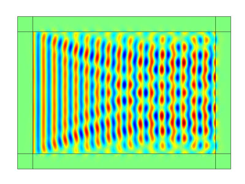

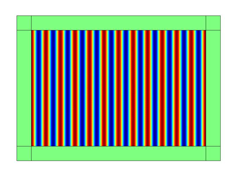

I tried to simulate a TM plane wave by setting background electric field Ey=exp(-j*emw.k0*x).
PML is surrounded by the rectangle simulatd area.
When I set parameters epsilon/mu/conductivity as air (epsilon=1, mu=1,conductivity=0)all over the geometry(PML+simulated area), I can get pefect plane wave. However, when I set parameters as other material(epsilon=2, mu=1,conductivity=0) all over the geometry,I can not get pefect plane wave.
BTW, the thickness of PML is one wavelength.
The attached images are the results of these two different settings.
My question is:
in order to get perfect plane wave, how to set PML parameters if the simulated area is not air?
for me it looks like your lateral sides are not "Perfectly" matched and you have reflexion from mthe lateral sides interacting, but this is just a guess.

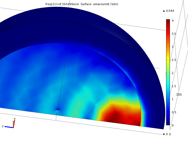

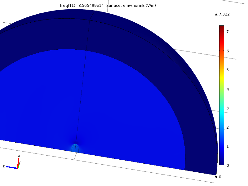

If I use air in the surrounding and the PML subdomains, the solution looks nice. If I switch both permittivities to some value unequal 1, I get severe errors in the solution. (See pml_glass.png). I also tried setting the permittivity of the PML region equal to 1 and the surrounding of the particle to some value unequal 1. Same wrong results.
Seems like these are UPML (UnPerfectly Matched Layers ;o)). Unfortunately, the documentation is not of much help here. Has anyone experienced the same issue or does anyone have an idea?

an check that you have latest patch, fo me today this means 4.0.0.993, see tha main COMSOL web site
Thanks for hinting me at the wave vector definition. sqrt(epsilon)*k0 indeed did the trick. This is somehow inconvenient, because when changing the material of the surrounding domain, you'll also have to change the incident field definition. The only solution I see so far is to adding a global variable with the refractive index.
