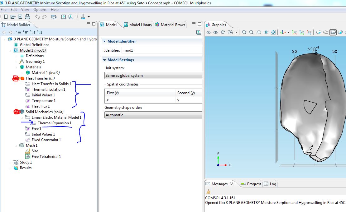

Hi Simona,
What I did before was combine two different physics. Heat transfer in solids and Structural Mechanics. The analogy of the Fourier's Law of Heat Transfer and Fick's Diffusion was used for the moisture diffusion in the media that I was studying. Then for the hygroscopic swelling part, I used the structural mechanics module. You can add the thermal expansion node in structural mechanics. Attached is the picture of what I did.
Hope that helps.
Jonathan
Hi Simona,
Hope that helps.
Jonathan
