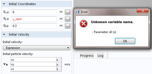

Particle Tracing Initial coordinates cannot be a parameter
The initial velocity in release from grid can be set by a parameter but why can't the initial coordinate be set by a parameter (see attachment)? Makes it really tough to plot trajectories in the application builder where things can only be controlled by parameters.

It is not true that "things can only be controled by parameters" in the Application Builder. Search for "Model Data Access" in the Application Builder documentation, it should clarify things.
