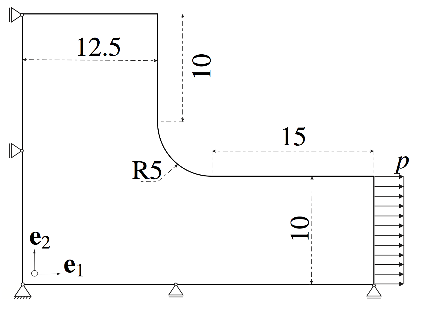

I'm doing shape optimization on the loaded knee. I've made the geometry similar to the image posted, instead I've just put a fixed constraint on the upper boundary and the force is working in the -y direction instead. I've made the geometry by creating two rectangles and using the difference tool. I've also added a fillet with radius=5.

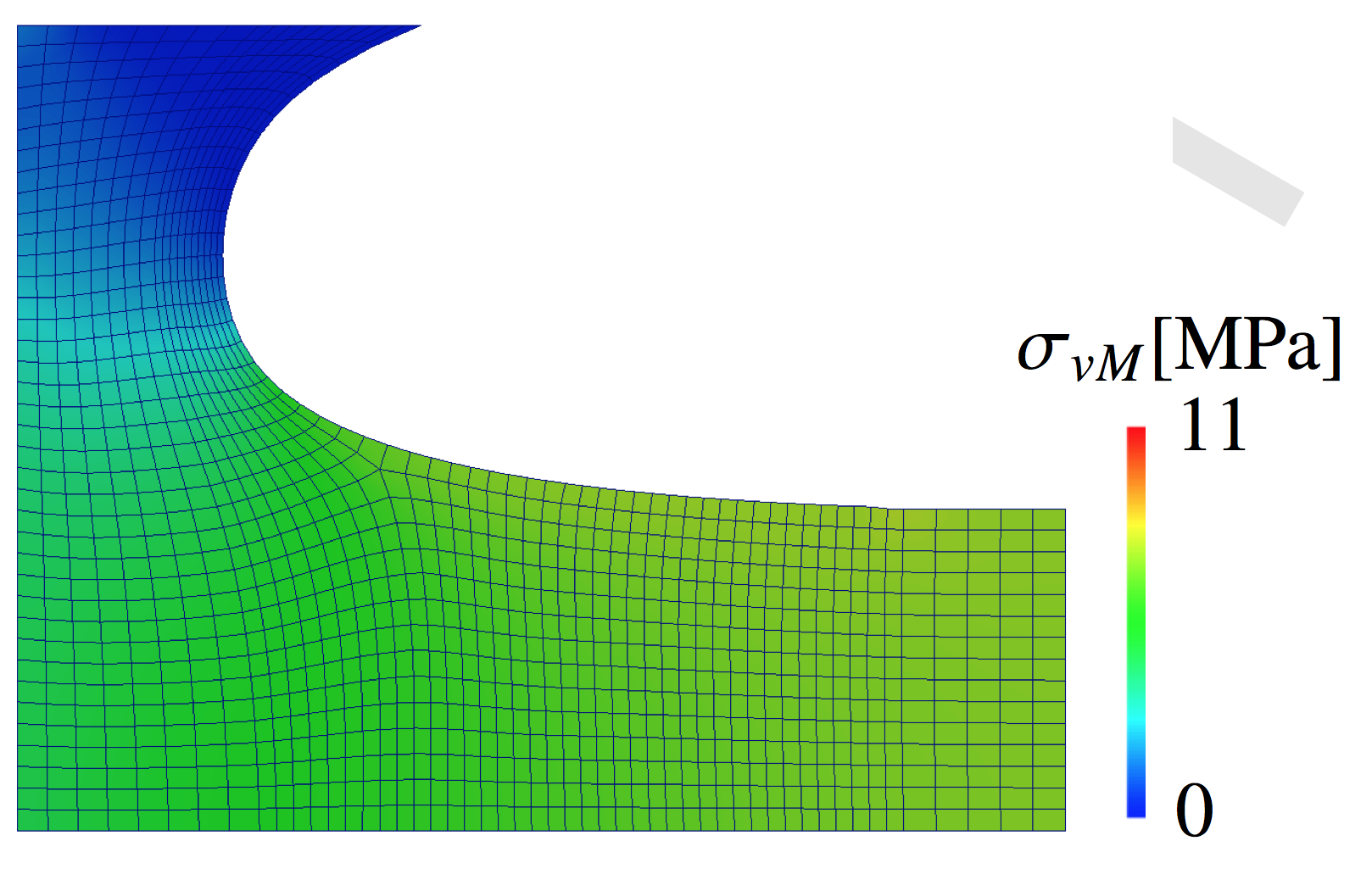

My problem is that shape optimization doesn't work properly, I want my result to look something like result.png (attached), but instead it looks like result2.png
