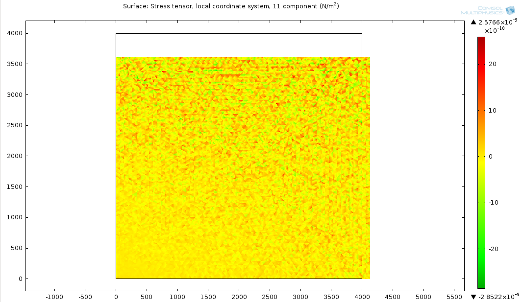

Changing to plane stress works for the strains. However, the x-stress result is still wrong. In theory, it should be x-strain multiply by E, which should yield about 9000Pa, but the result i'm getting is 4e-10, which is weird. Also the values fluctuates and there is no smooth data. Could this be a resolution problem? Please advise. Thanks.

Theoretically, Sigma_xx should be exactly zero. COMSOL returns a value of the order of 10^-10 because of finite numerical accuracy. In other words, the Sigma_xx plot shows you numerical noise. Your mesh is actually much finer than really needed for this application.

I'm a little confused. I agree with the z-stress (sigma33) to be zero which is the case in the sim. and also the link that you provided. However, x-stress should not be zero (sigma11), which is what is stated in the link too. Also, given that I have a proper value for x-strain (non zero), it should be inferred that x-stress cannot be zero too. Please advise on this.
Another thing is, is there a way to hand calculate the results when we use the plane-strain option. Thanks.

If you compute the expression at the link above you will find that it results in Sigma_xx=0. This is also trivial if you think about it: your model is invariant in the x direction so if you imagine taking a vertical cut in that part there cannot be any net force exerted by one side onto the other.

Thanks. I understand that now.
