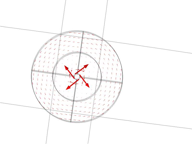

Anyway, I don't think Perfect Magnetic Conductor is the correct boundary condition. According to the documentation it sets the tangential component of the magnetic field to zero, which is not what I want. I tried applying it (in union mode) and you can see from the attached image that the current density in the coil is not right.
