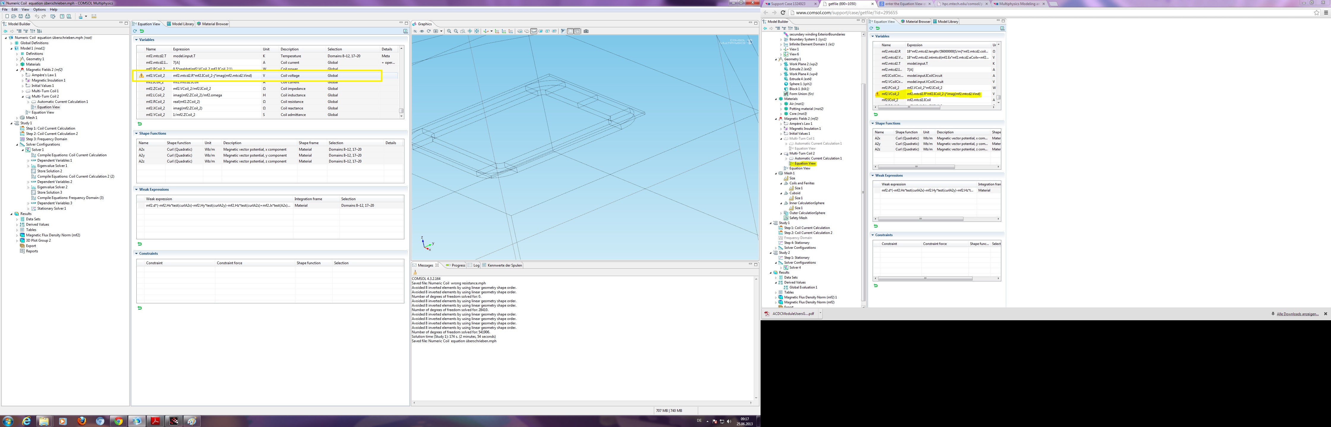

unfortunately nobody could help me so far. So I had to ask the support. If anyone has the same problem. Thus, this response of the support should perhaps be helpful.
Dear Viktor,
The Coil Resistance variable in Frequency Domain is computed as the ratio between the coil Voltage and Current. The voltage is, in turn, computed by integrating the electric field in the coil, so the accuracy of the resistance depends ultimately on the accuracy of the electric field.
Unfortunately, especially at low frequencies, the real part of the electric field distribution tends to be dominated by noise. This is a consequence of the omega^2*epsilon term in the equation being relatively small.
Now, as long as you can neglect the real part of the electric field (in other words you do not consider any conductive materials), you can get a much more accurate resistance if you make its definition consider only the imaginary part of the field. In practice, what you need to do is enter the Equation View of the Multi-Turn Coil Domain 1, and change the expression for mf2.VCoil_2 to the following (please see the attached screenshot "equation.png":
mf2.mtcd2.R*mf2.ICoil2-j*imag(mf2.mtcd2.Vind)
Now the resistance shows a much lower value (around 0.08 ohm) that confirms the analytical solution.
I hope this will help you. Please let us know if you have further questions.
after the changes the real component voltage drop of the coil not so high. The resitanse is not exact but better then before.
