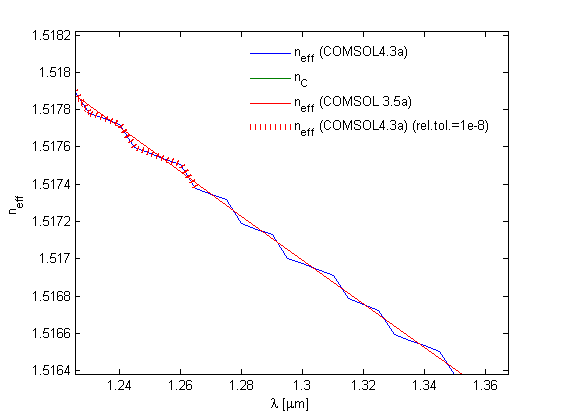

I use the step-index model found in the tutorial in Comsol 4.3a and insert the parameters that I am using. Then I make a wavelength sweep where I am running comsol and matlab together through LiveLink. When I compare my results off effective index neff(lambda) and propagation constant beta(lambda) (lambda is wavelength) with my previous results in Comsol 3.5a I see oscillations in both neff and beta in the new results in comsol 4.3a. The funny thing is that the oscillations are minor and oscillate nicely around the values obtained in Comsol 3.5a. The problem is, I cannot do nummerical derivates, which I need to do afterwards, off the obtained neff and beta.
With my inquiry I've attached a png figure of the results of neff, where you can see the blue line (comsol 4.3a result) oscillating nicely around a red line in the middle of the oscillation (comsol 3.5a result).
The other plots are of different precision of the comsol solver. They did not do anything to remove the oscillations.
