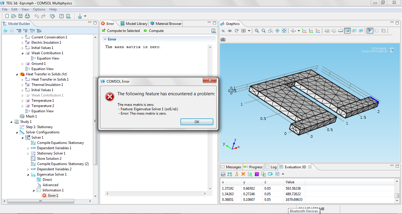

Posted: 1 decade ago 16.03.2014, 08:46 GMT-4
Dear Sir,
Thank you in advance, Am simulating Thermoelectric generator using Seebeck effect by means of Weak contribution approach..
INPUT: temperature gradient between thermo couple (Temperature)
OUTPUT: voltage flow across thermo couple (Electric potential)
I rectified all my errors. I changed "materials density and poison ratio value.." also
but still it show "Error: the mass matrix is zero"
I have attached the error image here.. Please help me to overcome this error.
Dear Sir, Thank you in advance, Am simulating Thermoelectric generator using Seebeck effect by means of Weak contribution approach.. INPUT: temperature gradient between thermo couple (Temperature) OUTPUT: voltage flow across thermo couple (Electric potential) I rectified all my errors. I changed "materials density and poison ratio value.." also but still it show "Error: the mass matrix is zero" I have attached the error image here.. Please help me to overcome this error.
