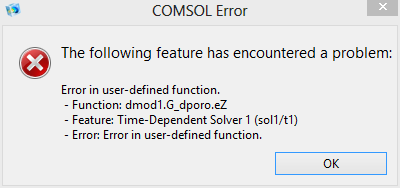

I am using poroelasticity module. I defined a analytic function named G. It is a function of poro.eZ (strain component in z direction), G=f(poro.eZ), and I can plot out the figure of the G(poro.eZ) correctly. But when I try to compute the model, there is an error, the screen shot of which is attached.
What is the meaning of "Function: dmod1.G_dporo.eZ"?
Anyone can tell me what is the problem of that? Any suggestions to solve this error? thanks a lot!

I have actually tried change the name of the function into other name, like "S", but there is still the same problem. If there is a typo, I think I can not plot out the figure of G vs. poro.eZ, but actually it can be correctly plot out.
Do you know what is the meaning of the character "d" in the error function of "dmod1.G_dporo.eZ"? Does it mean derivative?

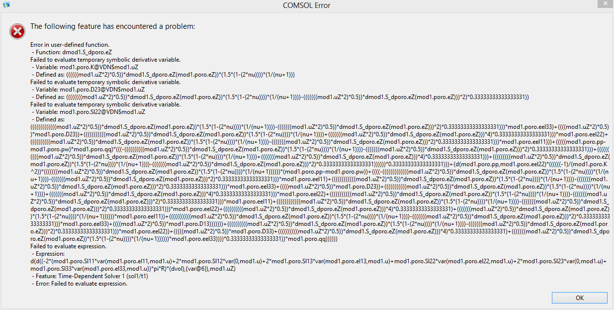

Sometimes, another error showed (attachment).

Sometimes, it will show error "failed to evaluate temporary symbolic derivative variable", what does that mean?
