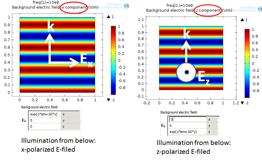

If 2D geometry is illuminated from below, then wavevector is k={0,k0,0}, meaning that wave is propagating along y-axis.
For plane wave, electric and magnetic fields are normal to the propagation direction. Hence, you have two choices: electric field can be x-polarized or z-polarized.
For x-polarization, background electric field is defined as E={exp(-j*emw.k0*y,0,0)}.
For z-polarization, background electric field is defined as E={0,0,exp(-j*emw.k0*y,0,0)},
as illustrated in the attached plot.
Sergei

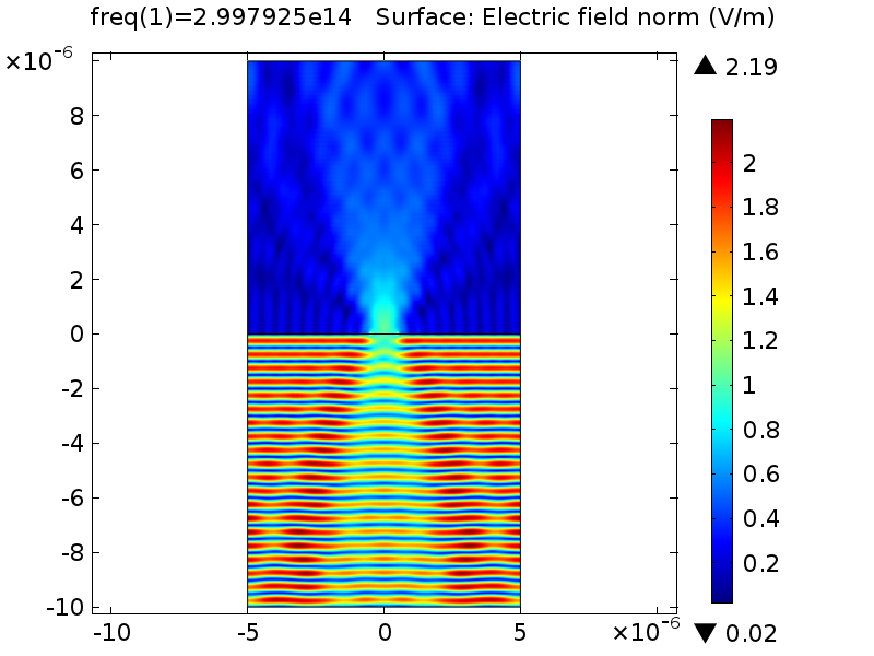

Attached is field distribution obtained using Scattered Filed formulation for periodic array slits in 2D case.
