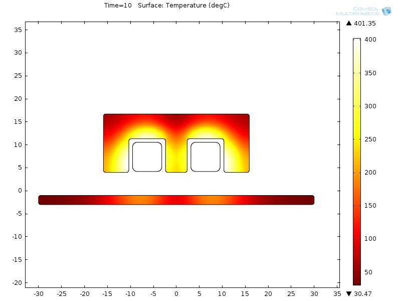

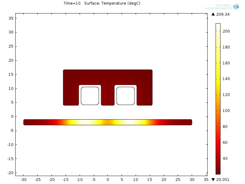

I have some problem with an induction heating simulation which has a magnetic flux concentrator (a material with a really high relative permeability) in it.
As a result, the metal plate heat up more with a mur=1 for the MFC than a mur=1.27324e7, which is wrong.
Could someone can tell me if I did an error on my model or if I misunderstood something?
My model and results are attached.
