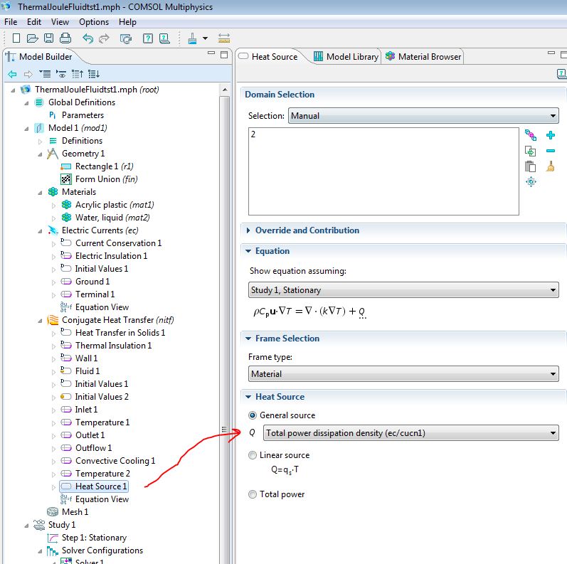

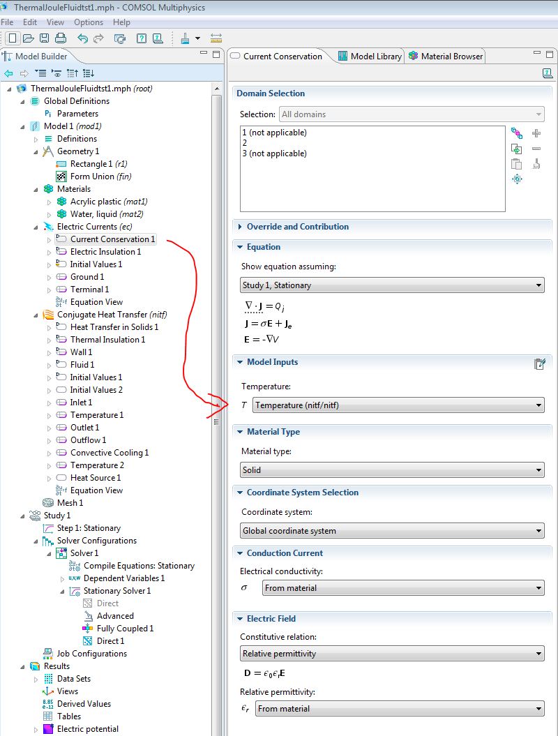

you must ensure you turn the links on between EC and NITF once in EC for the temperature (Current conservation node), then you need to add a heat sorce in the NITF fluid domain linked to the EC Joule heat dissipation
I use NITF as this has solid, and fluid heat exchange included (Solid+HT+SPF combined physics)
