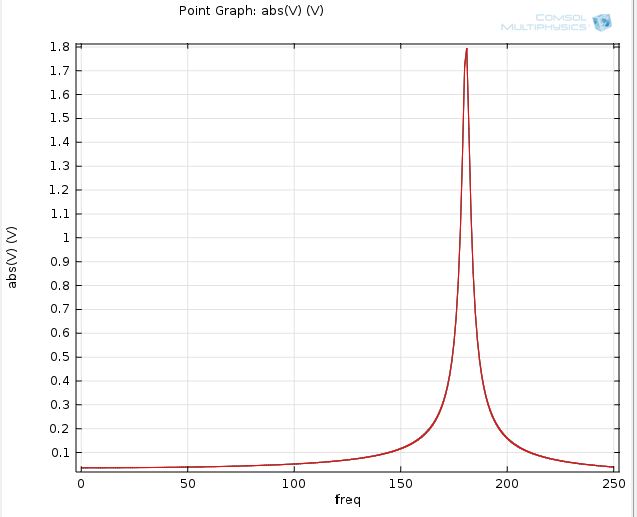

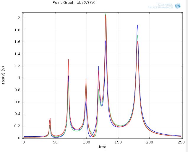

I tried floating potential and terminated boundary conditions. I am plotting electric potential amplitudes of arbitrary points on upper surface of the PZT. My FRF is between 0-200Hz and there are 6 modes in this range (they all can be observed in my measurement point). I attached the plots for:
case 1) Zero charge: It is resulting peaks at every natural frequency and arbitrary points on PZT have different amplitudes at each mode as expected.
case 2) Floating potential case: Arbitrary points on PZT have same amplitude so the uniform potential distribution is obtained. However, there is only one peak on the FRF. I lost the information for the other modes

I see that floating potential should be working. My question is why is it eleminating the peaks at other modes and resulting in only one peak?
