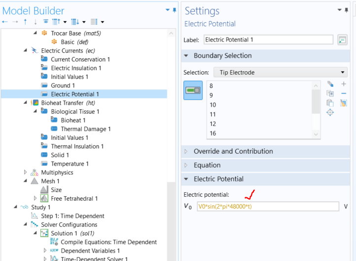

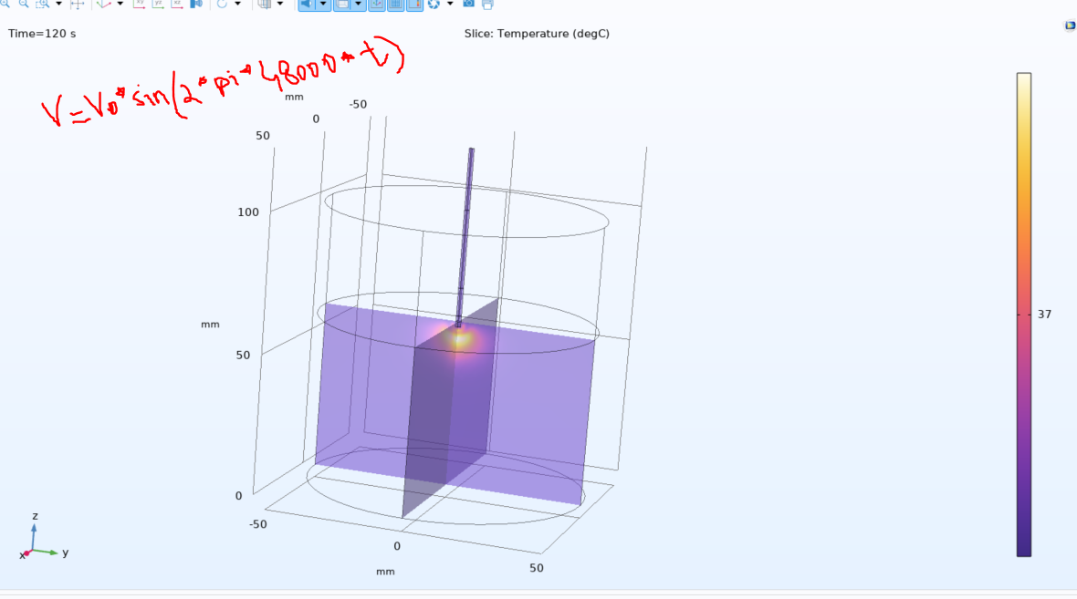

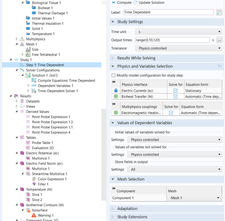

Something is not right with the physics and modeling here. If your frequnecy is 48 kHz, then you need a time step in the order of 1 microsecond to resolve each period. It will be difficult to run an analysis for 120 seconds, since that would require > 100 million time steps.

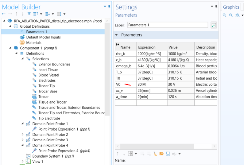

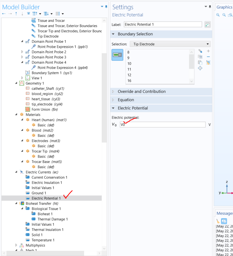

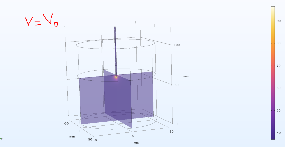

Thanks, I got your point. I changed the time step to 100ms and frequency to 5 Hz, now I am getting the voltage graph (I was just checking the output).
You mentioned that 120s and 48KHz setting is hard to get. What does this mean, are you talking about the computational cost?
If I want to mimic RF ablation, which runs on 480KHz, then, what will be optimal setting?
Thanks in advance.
