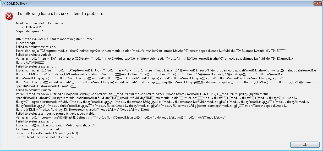

I am trying to simulate the movement of a 1 mm diameter ball inside a chamber. There is a water flow on the top of chamber, from left to right. I am using fluid structure interaction (FSI).
I keep getting the same error message that says
Nonlinear solver did not converge.
Time : 4.6875e-005
Segregated group 2
Attempt to evaluate real square root of negative number
Function: sqrt ... (and so on)
I also get a list of warning saying that "Inverted mesh element near coordinates ..., ...) that are located inside the ball (which is linear elastic solid material). I am also confused because it supposedly have less deformation compared to fluid area.
Any help or idea will be greatly appreciated. Thanks in advance.

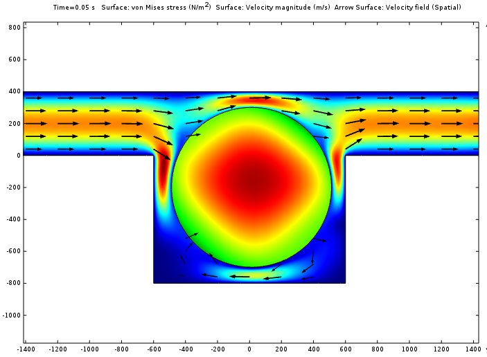

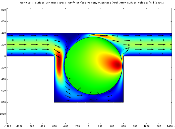

I changed your uploaded program with following modifications in the study section.
1) Segregated to Fully Coupled.
2) Free to Strict in time stepping with Initial step 0.001, Maximum step 0.01.
Based on this, I got attached figures. It looks buoyant solid sphere blocks right flow channel after 0.0924 seconds. I hope this helps you.
Myungwu

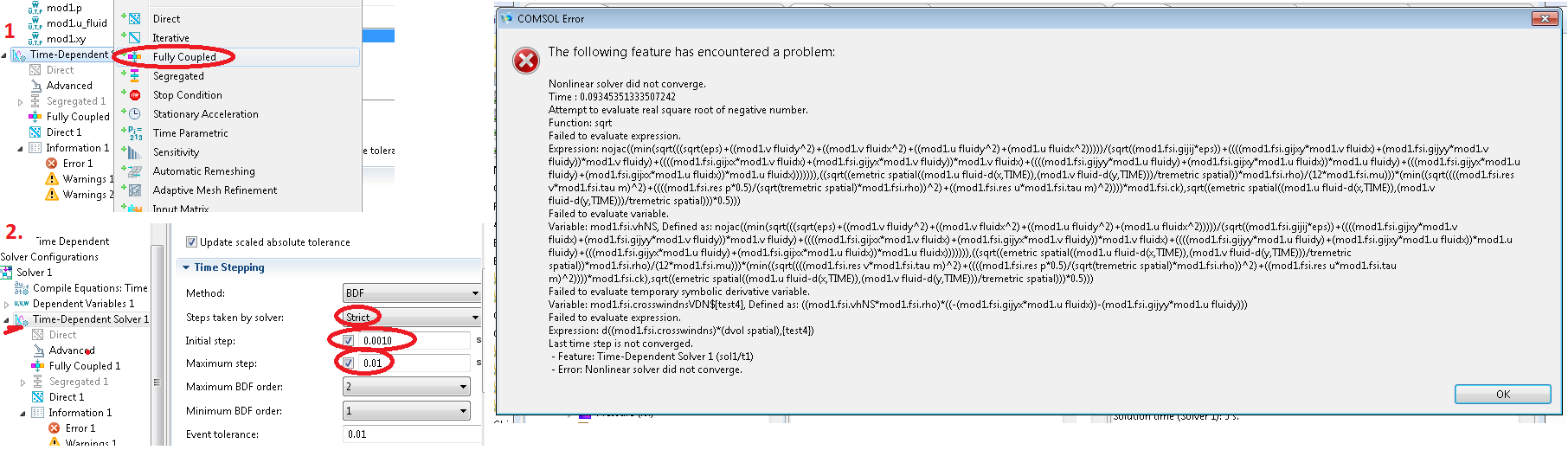

Posted: 1 decade ago 16.11.2014, 22:33 GMT-5
Hi Myungyu,
thank you so much for help solving this problem! I have yet found the solution until now and your help is greatly appreciated.
I followed your suggestion, but I got this error message instead. Attached are the figure of steps that I believed following you, the error message, and the error *.mpg file (let me know if you need the comsol file with results).
One thing that change compared to before is that i now use version 4.4b. Does it change anything?
Could you tell me what I did wrong please? Thank you again! I really appreciate it!
Sofie
Hi Myungyu, thank you so much for help solving this problem! I have yet found the solution until now and your help is greatly appreciated. I followed your suggestion, but I got this error message instead. Attached are the figure of steps that I believed following you, the error message, and the error *.mpg file (let me know if you need the comsol file with results). One thing that change compared to before is that i now use version 4.4b. Does it change anything? Could you tell me what I did wrong please? Thank you again! I really appreciate it! Sofie

Your result is exactly same as mine. If my understanding is correct, the circle moves to right-up direction and finally blocks the fluid flow after 0.0934 second. Please draw the fluid flow profile from the Results with 2D at time 0 and 0.09 second. You can see the circle is moved. I did not attaching figures because, for some reason, "Attach File" button of this website did not work at this time. I hope this is the result you want, otherwise please let me know.
Myungwu
