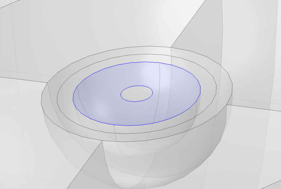

I have been trying to get a topology optimization to work for my model. I am using the Membrane Interface and want to use topology optimization with an eigenfrequency study to optimize for a high quality factor. Basically I want Comsol to shape the membrane between the outer ring attached to substrate and a central defect. The attached png highlights the area I want to change the geometry for.
