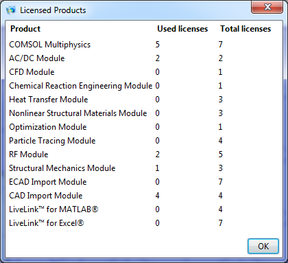

We have a network license for COMSOL 4.3a. This is a fairly large laboratory setting.
People here have a bad habit of leaving COMSOL open on their workstations when they go home for the day, locking up all the licenses.
See attached screenshot, for example. I can't use the AC/DC module even at 7:15 pm, when I know that all the engineers have gone home.
How can I figure out WHO is using the license? (As in, the name of their computer on the network.) So I can go close COMSOL on their workstation :)

This should help: www.comsol.com/support/knowledgebase/1142/

Benjamin, that worked perfectly. Thanks!!
