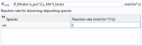

As seen in the "Mn_Dissolution.png", Li+ ions are generated during this reaction which needs to be coupled back to the Li+ species balance which is solved internally in the Lithium-Ion Battery Interface. So, to do this, I used the Non-Faradaic Reactions Node under Porous Electrode Node where we can add this source as , which is coupled back to the Li+ species balance as given in the COMSOL equations "COMSOL_Eqs.png" of the Porous Electrode Node.

tab in "NonFaradaic_Rxn.png" should result in the increasing concentration of Li+, however a decreasing trend was observed. In another run, a negative value (-R_Mndiss * a_pos * 2/y_Mn * t_factor) was entered which gave an increasing trend for Li+ concentration. What could be the possible reason behind this behaviour?
- Secondly, what is the role of "Reaction rate (mol/(m^3s))" value under the "Reaction rate for dissolving-depositing species" (See "NonFaradaic_Rxn.png"). Should it be kept zero or equal to the magnitude of

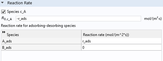

term. One of the COMSOL examples employing the Non-Faradaic Reactions node Adsorption-Desorption Voltammetry used the "Reaction rate (mol/(m^2s))" value as equal to entered for the source term (See "NonFaradaic_Rxn2.png"). Please clarify regarding the term's magnitude as well as sign.
