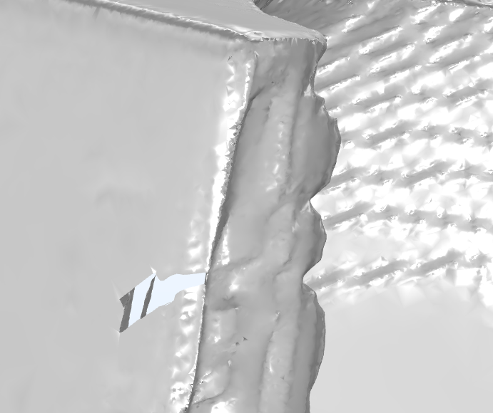

- There does not seem to be any figure attached.
- Are you trying to import a geometry file created with a different program?
Files created by other programs and mesh parts that come with comsol don't produce good geometry, and the shape of the geometry changes, even if you don't use "Simplified Mesh".

Kristian Ejlebjærg Jensen
COMSOL Employee
Posted:
11 months ago
07.11.2023, 05:05 GMT-5
Updated:
11 months ago
Performing verification using a mesh based geometry (importing the mesh part directly in the meshing sequence) is usually more robust than converting the mesh to a geometry. The Adapt and (new in 6.2) Remesh operations can be used remove bad surface triangles.
In any case, you might get better results by either using Prescribed Material/Void features to extend the selection of the Helmholtz filter and/or by increase the mesh size (while keeping the filter length constant) so that the design is better resolved. This should be a relatively fast process, if you only solve for the Helmholtz filter using a iterative solver.

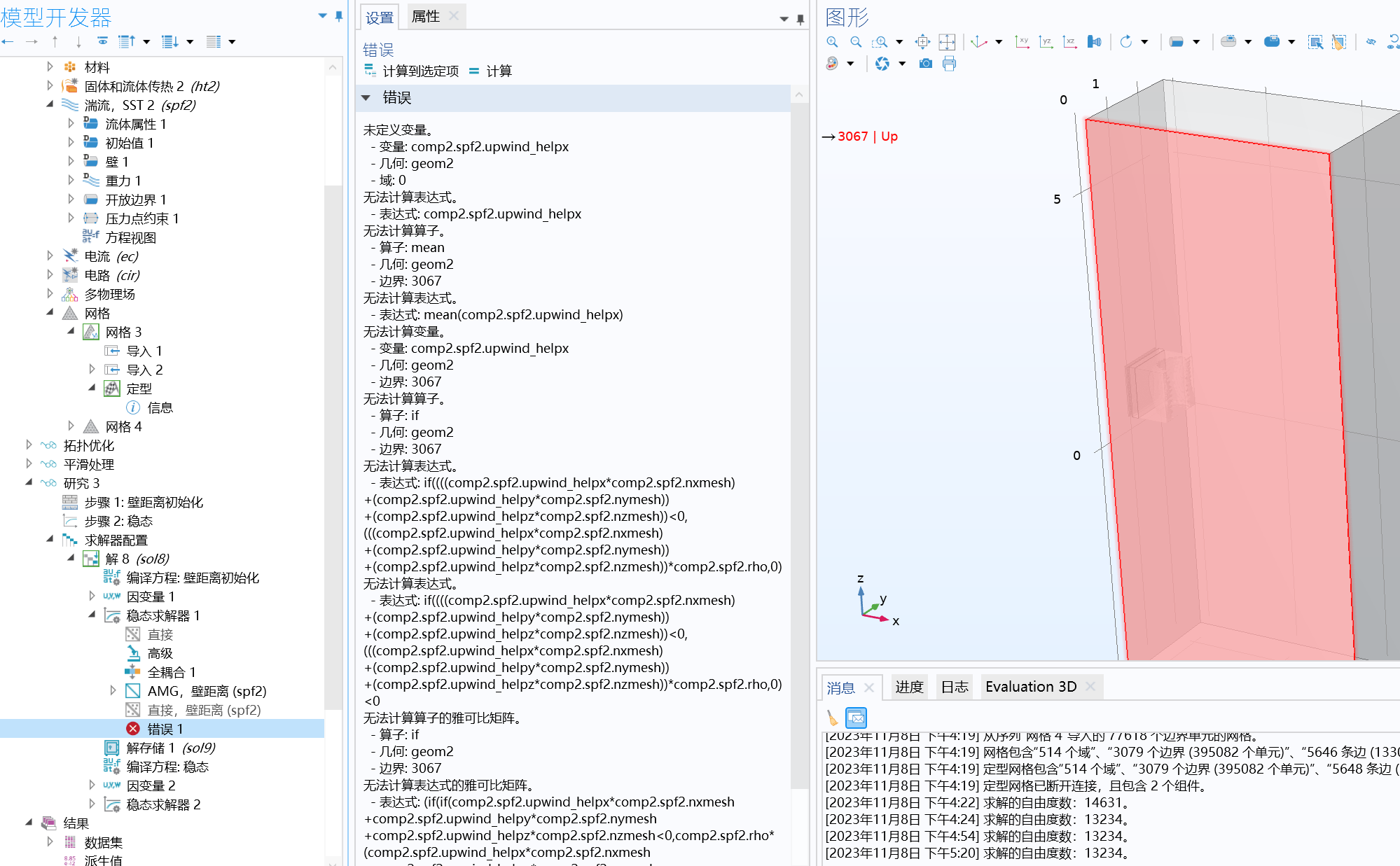

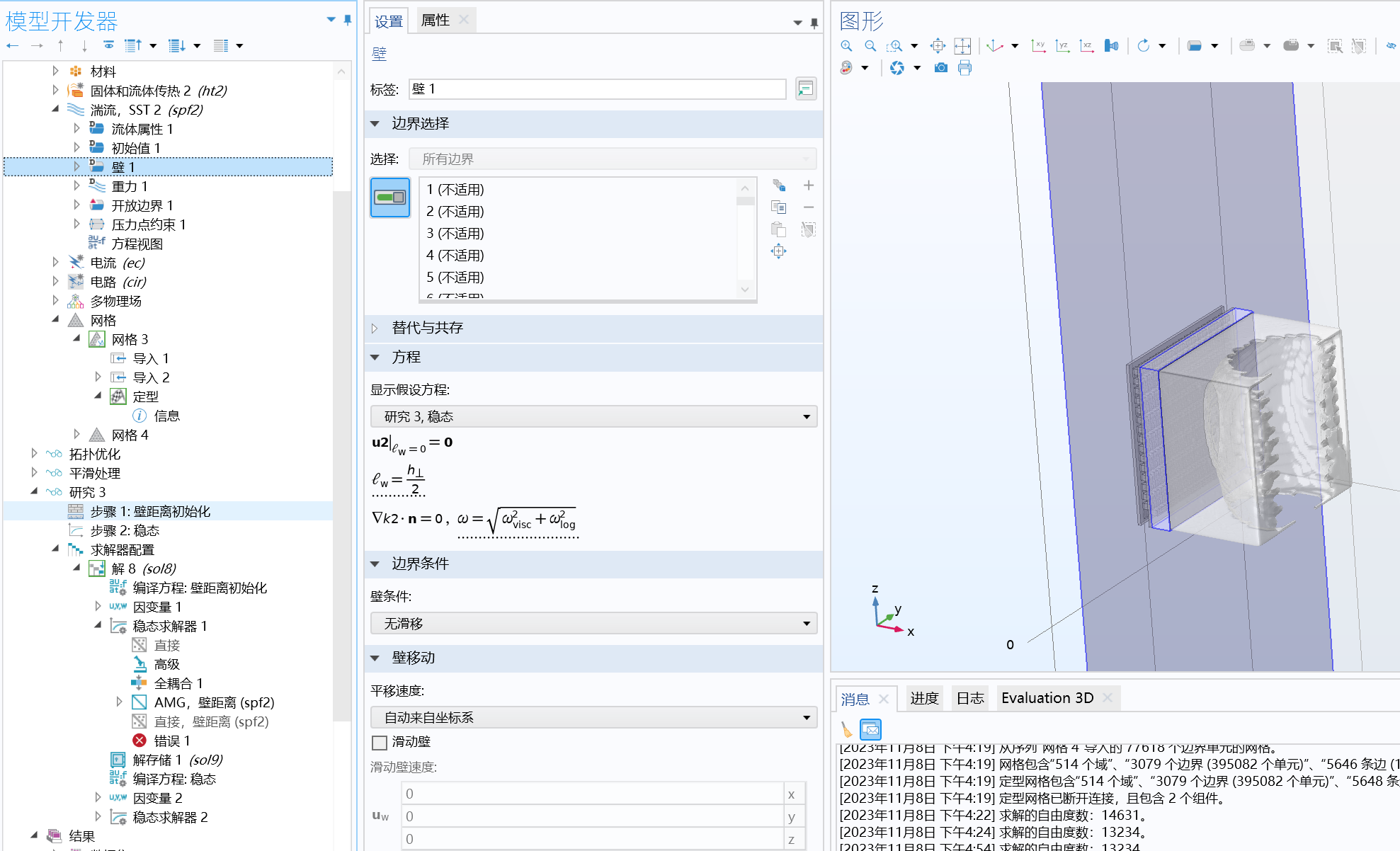

Dear Sir
I have taken your suggestion of importing the mesh part directly in the meshing sequence to validate it, but a new problem has arisen, i.e. "undefined variable: comp2.spf2.upwind_helpx; geometry: geom2; domain: 0". Boundary 3067 is the red face. I don't know how to solve this problem, can you please tell me how to solve this problem. Attached is my model tree for your reference. Thank you very much!
Best regards!

Dear Sir
Best regards!
COMSOL Employee
Posted:
11 months ago
08.11.2023, 06:40 GMT-5
"Domain 0" sounds strange. I suggest contacting support about that.
