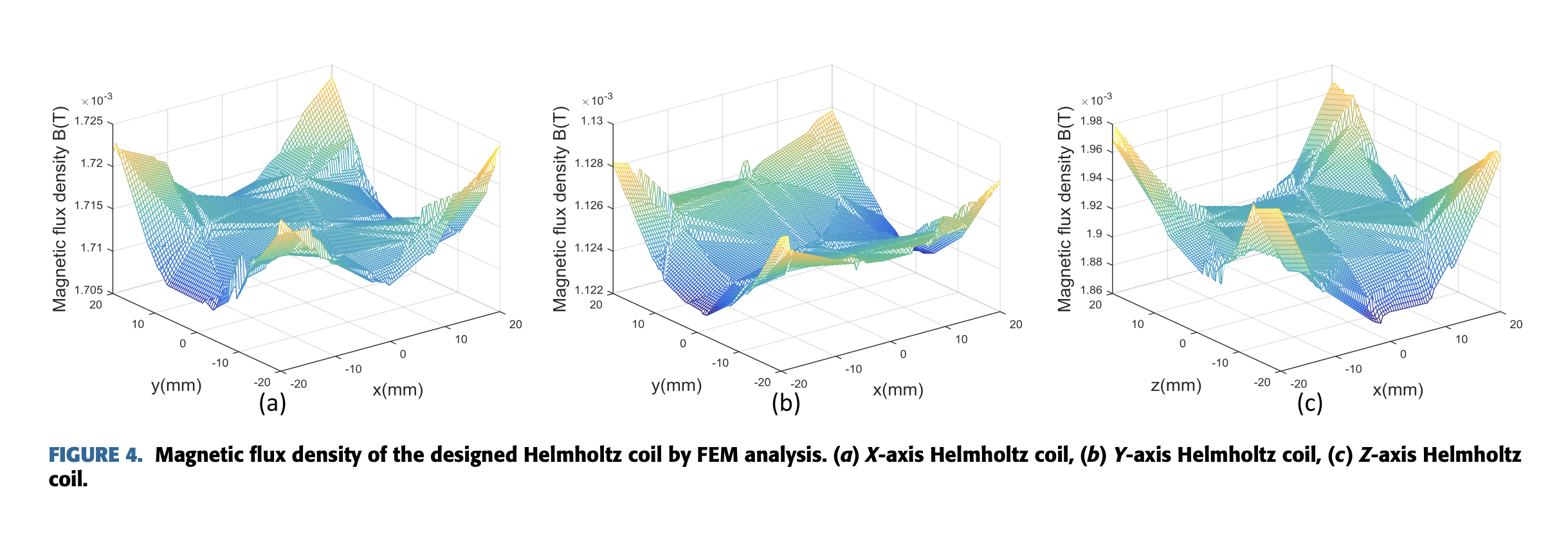

Hi, i am very new about comsol. and i want to plot the magnetic flux density for Helmholtz coils like the attached image. But i don't know how to make this plot. this attached plot is from https://ieeexplore.ieee.org/document/9057623.

You would do a surface plot (in a 2D plotgroup) with an additional "Height Expression" subnode. See the attached (version 6.1, you will need to compute the solution).
