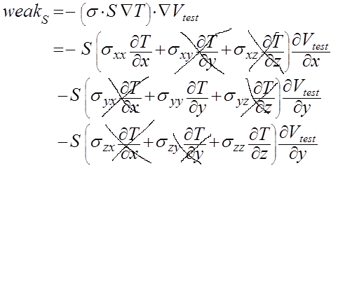

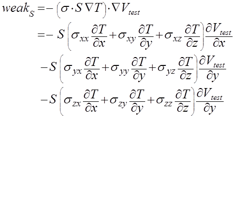

Posted: 1 decade ago 02.10.2013, 14:30 GMT-4
Jonatan,
Attached contains derivation of the thermoelectric weak contributions. Hopefully, this will answer your question.
Sergei
Jonatan, Attached contains derivation of the thermoelectric weak contributions. Hopefully, this will answer your question. Regards, Sergei

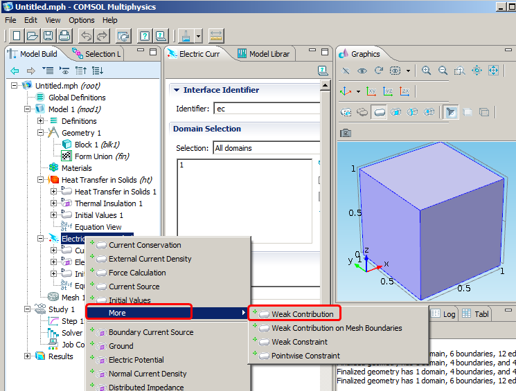

Posted: 1 decade ago 09.10.2013, 11:18 GMT-4
Ying,
To add ‘weak equation’ under the Electric Current node:
Right-click Electric Currents (ec) node and select More>Weak Contribution under domain features list (top section above the line)
Sergei
Ying, To add ‘weak equation’ under the Electric Current node: Right-click Electric Currents (ec) node and select More>Weak Contribution under domain features list (top section above the line) Regards, Sergei

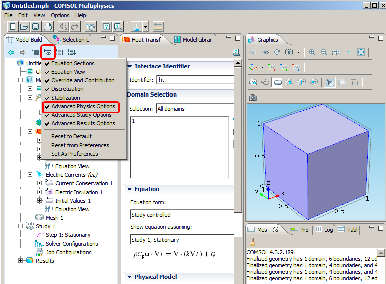

Posted: 1 decade ago 09.10.2013, 16:19 GMT-4
Ying,
To see "More/Weak Contribution" you have to activate “Advanced Physics Options” under “Show” button – see attached images.
Sergei
Ying, To see "More/Weak Contribution" you have to activate “Advanced Physics Options” under “Show” button – see attached images. Regards, Sergei
Posted: 1 decade ago 09.10.2013, 16:28 GMT-4
Dear Sergei,
Thank you very much! It's working now :D
Ying

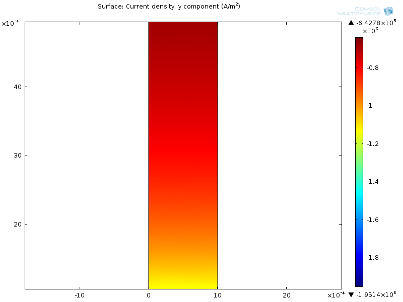

Posted: 1 decade ago 10.10.2013, 06:33 GMT-4
Dear Sergei,
I'd like to ask you some questions:
1)why in the 2D model you gave me you write:
(-k_ht*Tx+P*Jx_dc)*test(Tx)+(-k_ht*Ty+P*Jy_dc)*test(Ty) without volume integration?
2)where you have declared "P" ?
Attached you find my 2D axial symmetric model, there I can find only a heat release at one junction but no heat absorption at the other. Can you explain me where I am wrong and why?
Note that my file is more than 10 MB so I was forced to split it in 3 parts with winrar. Also i was forced to rename *.rar files as *.mph files so you have to rename the files in *.rar (otherwise the forum does not allow me to attach)
Hope this is not too boring for you...
Thank you soo much!

Dario,
Seebeck weak contribution is placed for current balance, "emdc" interface, in your case.
This term is shown in the attached image.
There are couple issues with your weak contribution expression:
1. According to Comsol sign convention, Seebeck weak term should be with “minus” sign.
2. Seems you are modeling material with isotropic electric conductivity: sigma_xx=sigma_yy=sigma_zz=sigma. Then, all off-diagonal terms for electric conductivity should be zero. Yet, those terms (containing sigma_xy, sigma_xz, etc.) are non-zero in your expression.
Sergei

Dear Sergei,
I have a question for the peltier test model: So you will get T and V for the result. How can I get the current (I) in the p and n legs to calculate the power?
Thanks a lot!
Junce
