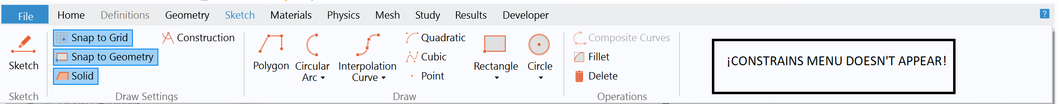

I have version 6.1 ClassKit Edition. I would like to use the "constrains" option, found in the "sketch" tab, to be able to limit the different distances that appear in my geometry, but I can't find it (As seen in the attached image).
I would really appreciate it if someone could tell me how to activate this option

Hello Alejandro,
This is a functionality included in the optional Design Module. Could it be that your license does not include that product? You can check on that by going to File > Used and Licensed Products.
Jeff Hiller
Hello Alejandro, This is a functionality included in the optional [Design Module](https://www.comsol.com/design-module). Could it be that your license does not include that product? You can check on that by going to File > Used and Licensed Products. Jeff

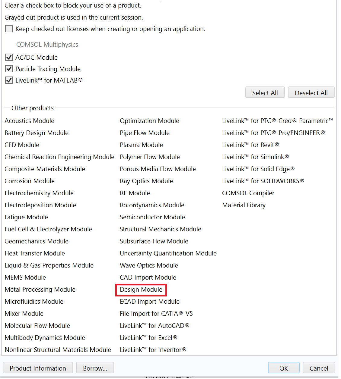

Hi Jeff,
Thank you very much for your answer. I have reviewed it, and as you will see in the attached screenshot, it is included in my license. So it seems that the problem comes down to "make visible" the particular constrains option, which I just don't quite see how to do.
Thanks again.
Hi Jeff, Thank you very much for your answer. I have reviewed it, and as you will see in the attached screenshot, it is included in my license. So it seems that the problem comes down to "make visible" the particular constrains option, which I just don't quite see how to do. Thanks again.
Posted: 2 years ago 13.03.2023, 17:45 GMT-4
Okey, I think you were right, it's in the "other products" section, so I don't think it's in the license I have.
