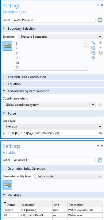

Attached is an example where the water level is even rising with time.
Henrik Sönnerlind
COMSOL
Posted: 3 years ago 10.03.2023, 08:29 GMT-5
