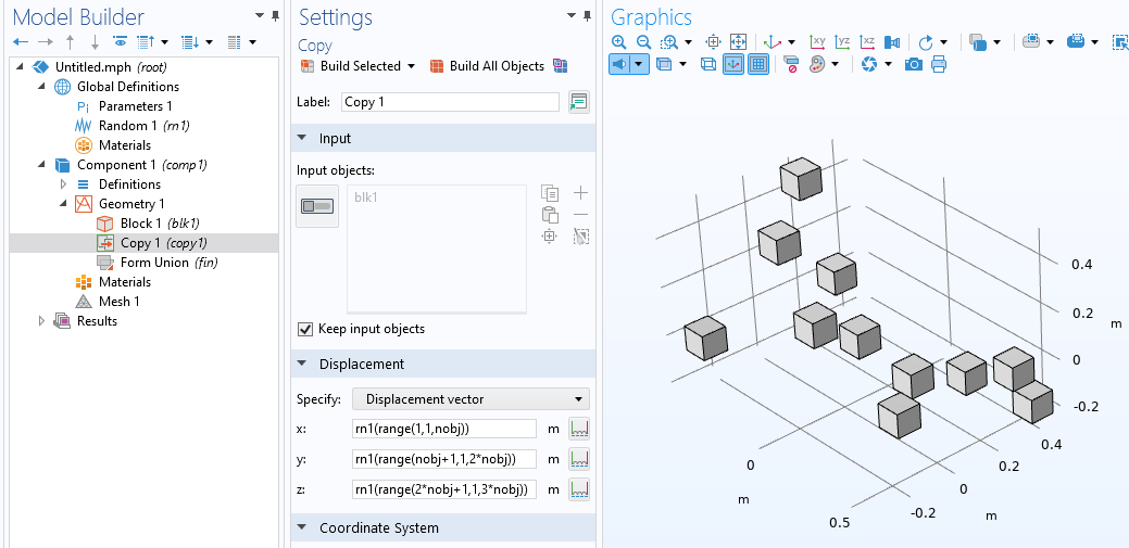

There are several possibilities.
One, very lightweight method, is shown in the attached screenshot: Use a Copy node referencing a random function.
A more sophisticated variant, using a model method, is described in this blog post:
https://www.comsol.com/blogs/how-to-create-a-randomized-geometry-using-model-methods/
An important thing to consider, is whether it is a problem or not if the generated objects overlap.
